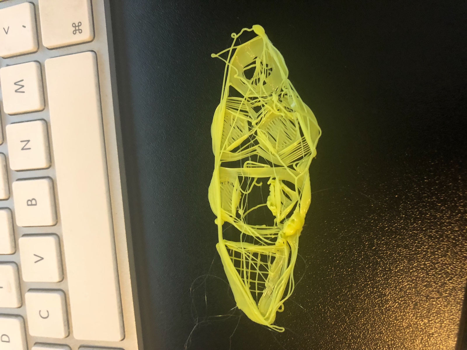

Hi ,
after successfully been able to center the printer, ( Help from this forum :) ) now when i attempt to print the 1st layers seem to be all over the place , doesn't stick to the heat bed , and from looking at the nozzle , the filament doesn't seem to flow as well as it did with the first print i've done.
Prints now lift off the board very quickly during the print process ( before a first layer is complete) and the design doesn't seem to go as it should be.
can any one advise what i should be looking at to help get past this issue?

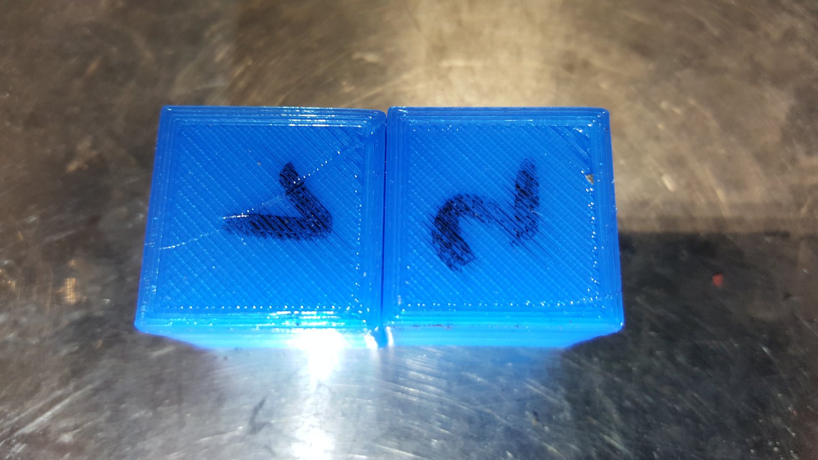

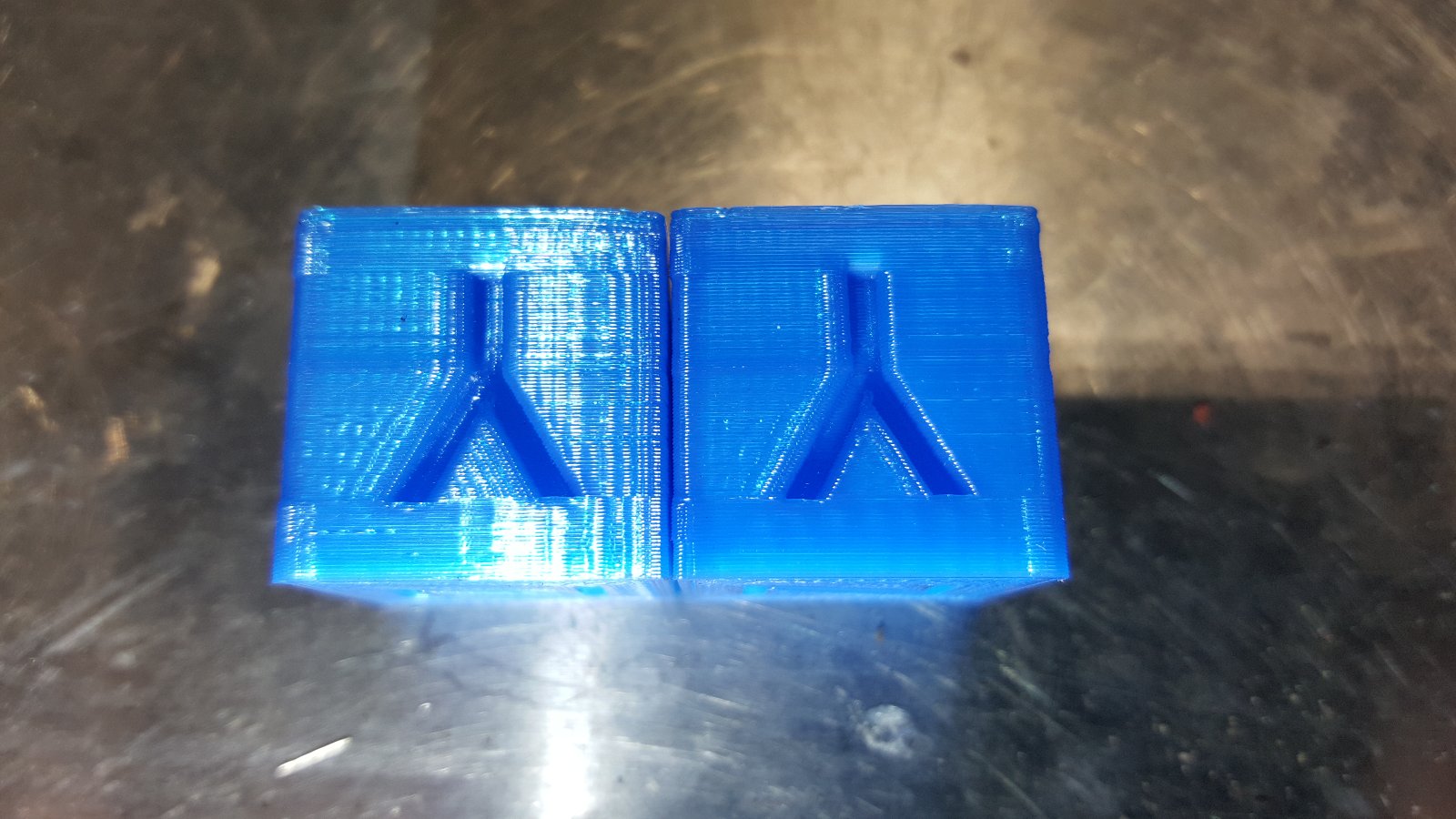

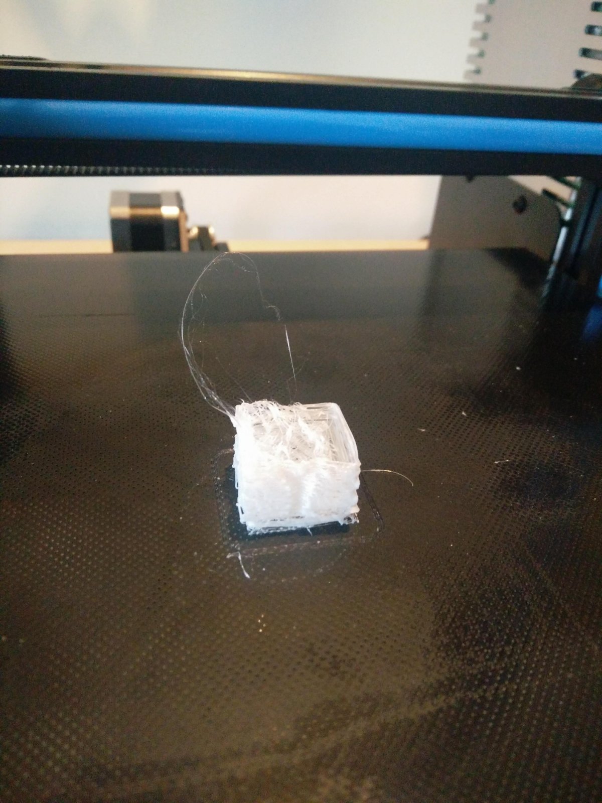

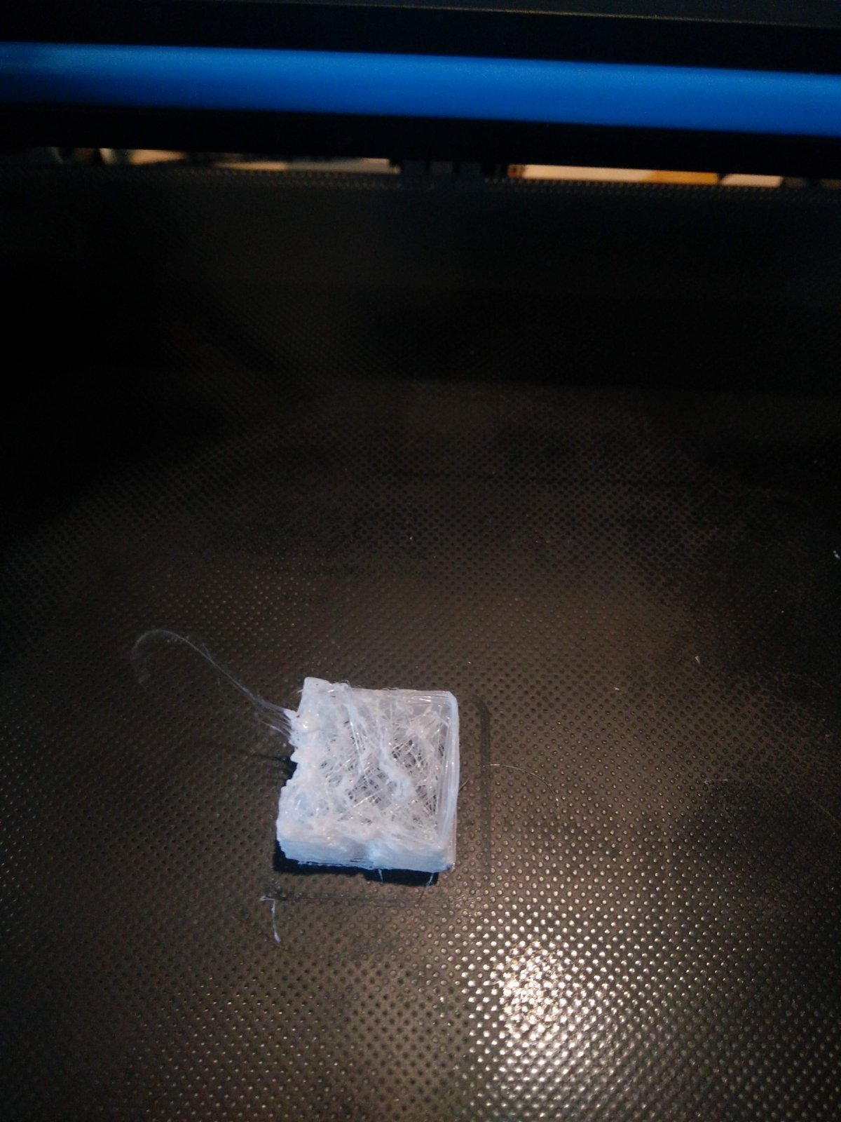

Dear MichaelK,
I have the same problems of Tyrant...
I print your cube directly form SD card and this is the result... :(
I can not understand.
I printed the dog withe the blue PLA and all was ok.
All the others works are some the cube....
What could be? Any suggestion?
It's my first 3dprinter, and I want to destroy it...:)
right side the first print, left right another intent... from the same file fron SD

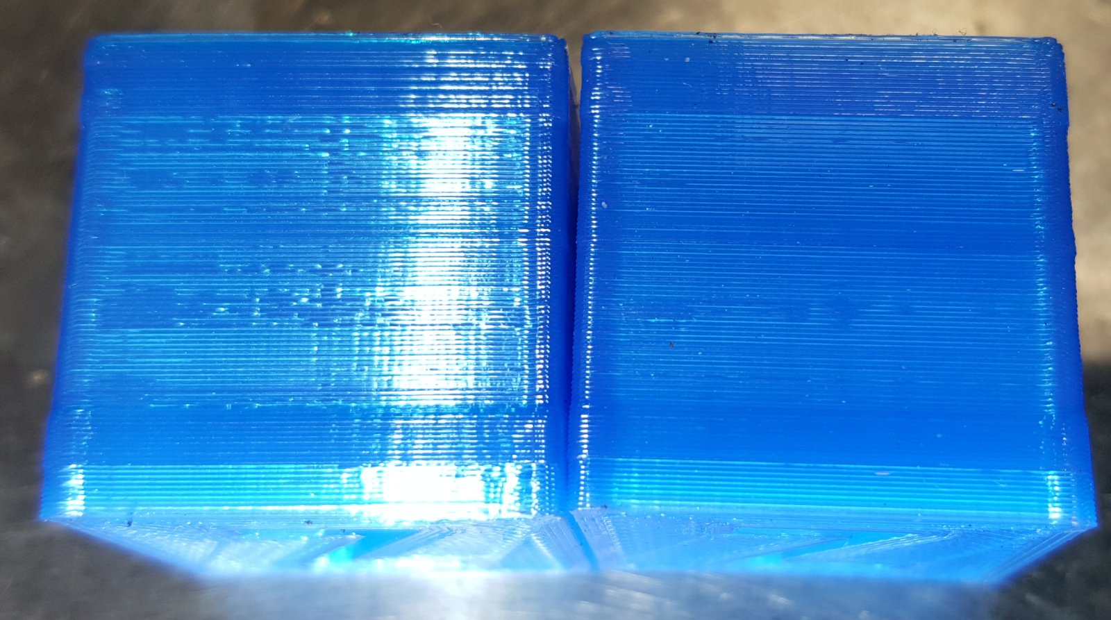

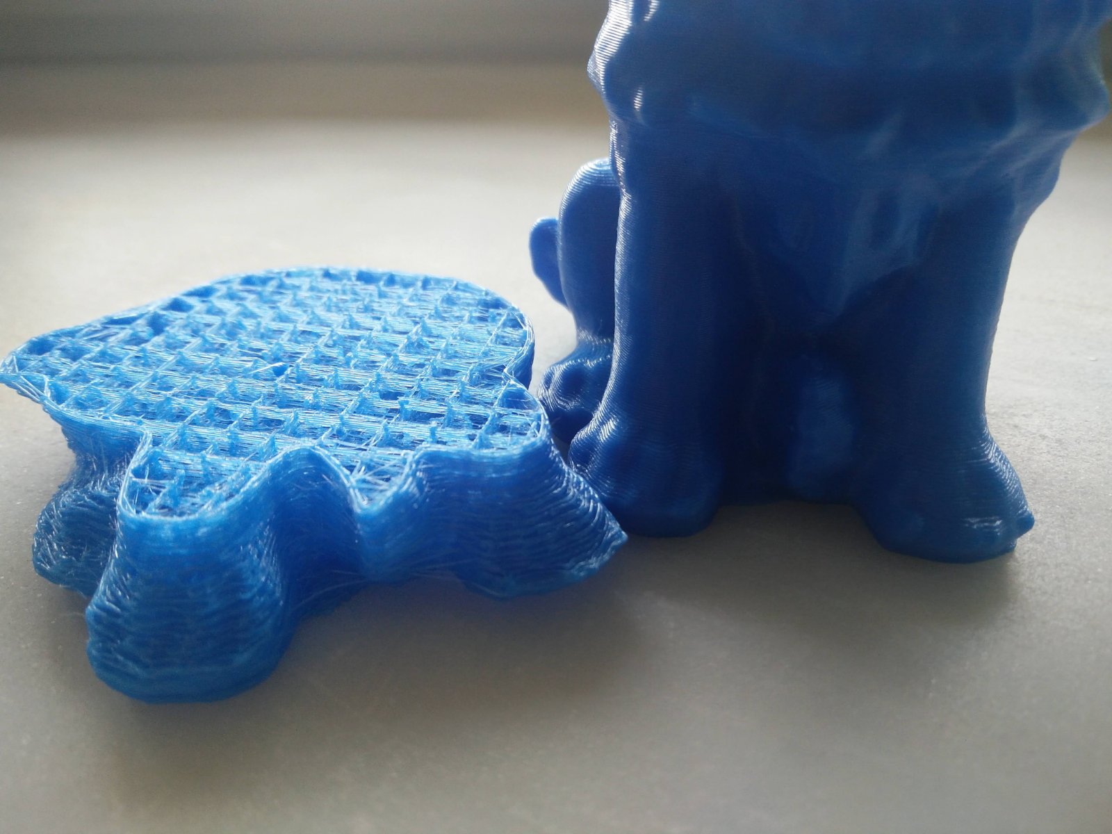

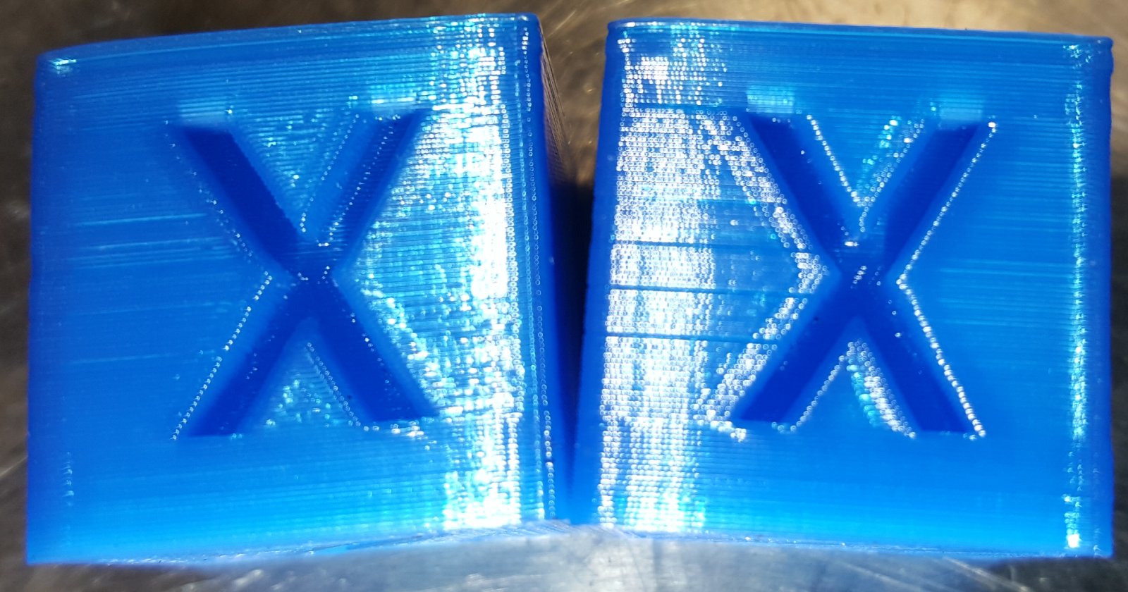

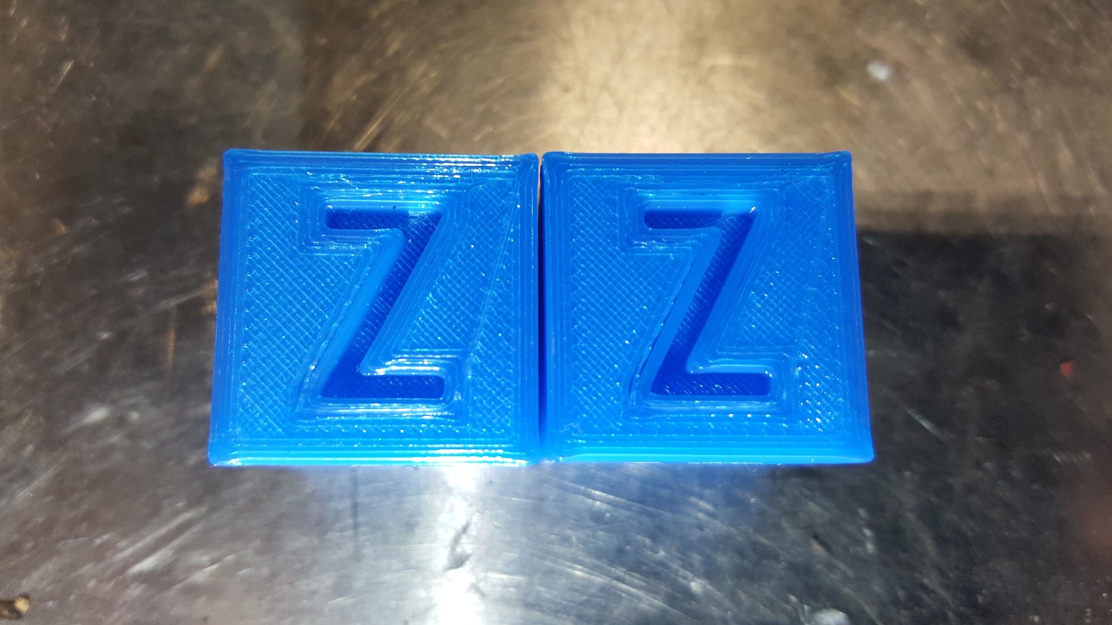

Hi everyone!
I got some printing issues too.
The main problem is the random outlining if the y-axis.
There are nearly everytime i got a print over 2 hours the last layers out of line.
Atm its instand layershifting.
Allready solved the problem of underextrusion. At first i measured the amount of extrusion, while give the command to extrude 100mm. There the printer only extruded 90mm. After align the steps/mm for the extruder steper, there was no change in quality. I recognized the teflontube in the hotend wasnt fitted to the end. After deassembling, cleaning and refitting the tube. The results where way better.
Now is the problem with y-axis and not sticking together of inner and outer wall layers. There is allways a tiny gap between them.
I printed the cube from michaelk aswell and like u can see in the pictures, the letters x and y arent in the center. Dont know if this is supposed to be.
Would be very great to get some advices.
The picture below the testcubes is a print of the "AIO ALL IN ONE Test" https://www.thingiverse.com/thing:2656594
There you can perfectly see the y axis problem i got atm.
