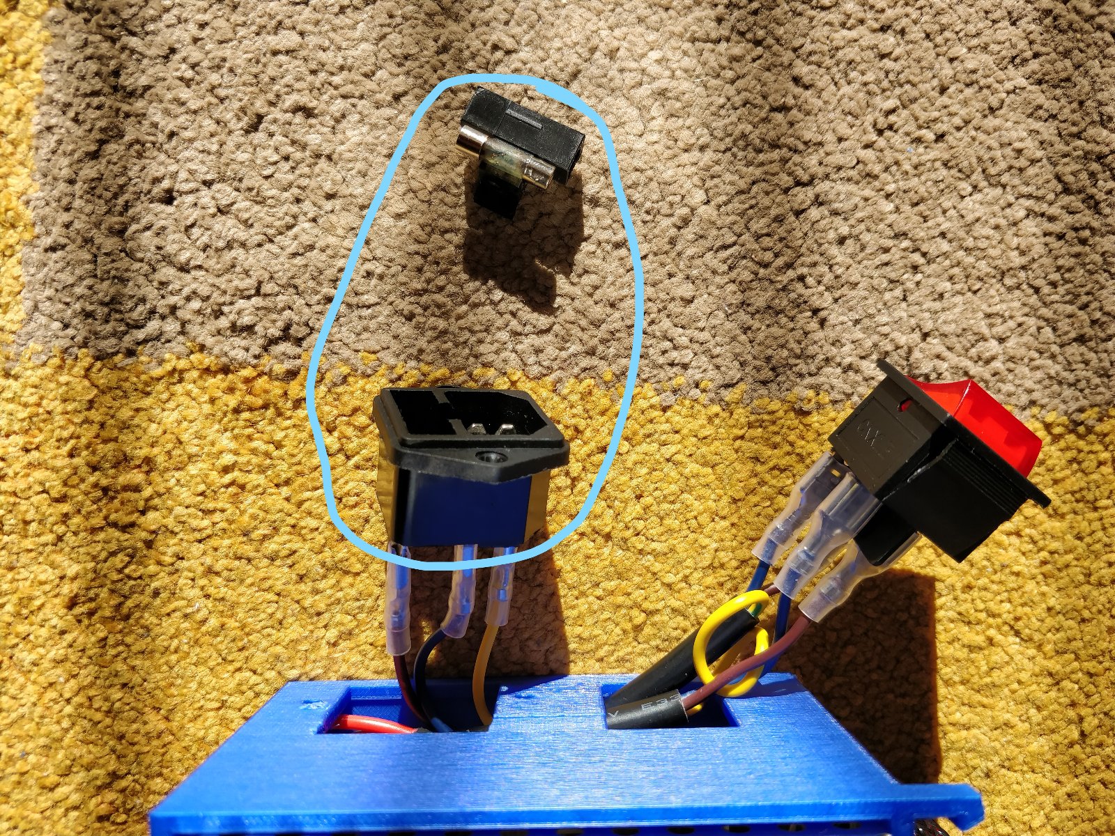

Hello I bought my Geeetech I3 Aluminum form Amazon and it worked great until yesterday. (EU-Version)
I printed a case for my power supply and I forgott to take a picture on the cable routing of my switch.
So the result is that the fuse blown on my power socket plug.
My question is which fuse do I need. I know that I need a 250V with a dimension of 5x20 mm but I can't read the current on the fuse.( For me it looks like a 3A fuse).
My second question is if the new cable routing of my switch is correct.
Greetings Viresneaker

Hello
my power supply is 12V 15 A
Here is the picture of the blown fuse in the blue circle

Hello thank you for the reply.
Input Power supply: 115V/1.5A or 230V/0.75A
So I need a Fuse with 0.75 A?
Or do I need a 10A because it is written on the Plug plastic (250V/10A)
On the blown Fuse is wirtten F_ 3 or 5 / 250V (can't read the current because of bad visibility)
That is why I am so confused what I need to use.

Re: Blown Fuse on power socket
Post by _kaktus_ »
Hi :mrgreen:
I in your case with a fast fuse 1A 230V AC.
