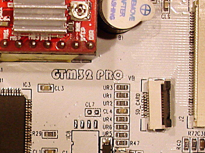

I removed the sticker from the speaker (or beeper) in my A10M and the volume level is much higher. On sticker is label : Remove after washing. Probably the Chinese assembly line operator does not understand it. I've seen many photos here where the sticker has been stuck.
- wycinek_GTM32Pro_vB.png (759.71 KiB) Viewed 4833 times

Re: Sticker on speeker
Frequency of speaker is changeable using the G-code .... S: frequency in Hz, P: duration in ms. Easy usable in start and stop code, but only without sticker.
Code: Select all
M300 S2500 P100
