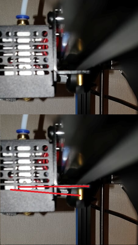

I've just receive my new A10 and I've got several quality issues :cry: .
First : the printhead is moving in all position even if I put the eccentric in the highest position => the printhead structure seem to be twist (see picture)

thanks for your answer. I've check the printhead wheel and event if I play with the eccentric screew the wheel turn and all the print head move from front to back, up and down and rotate :cry:

on the below video the eccentric is turn at the highest position that can

I've fixed the first issue by disassemble all the printhead and bend the metal guide to have a straight line :evil: . Now it's ok.
For the second issu I've not found any solution yet. I've played with eccentric but nothing, the bed still not moving smoothly and I've got a wobble effect
