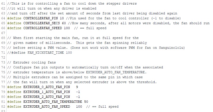

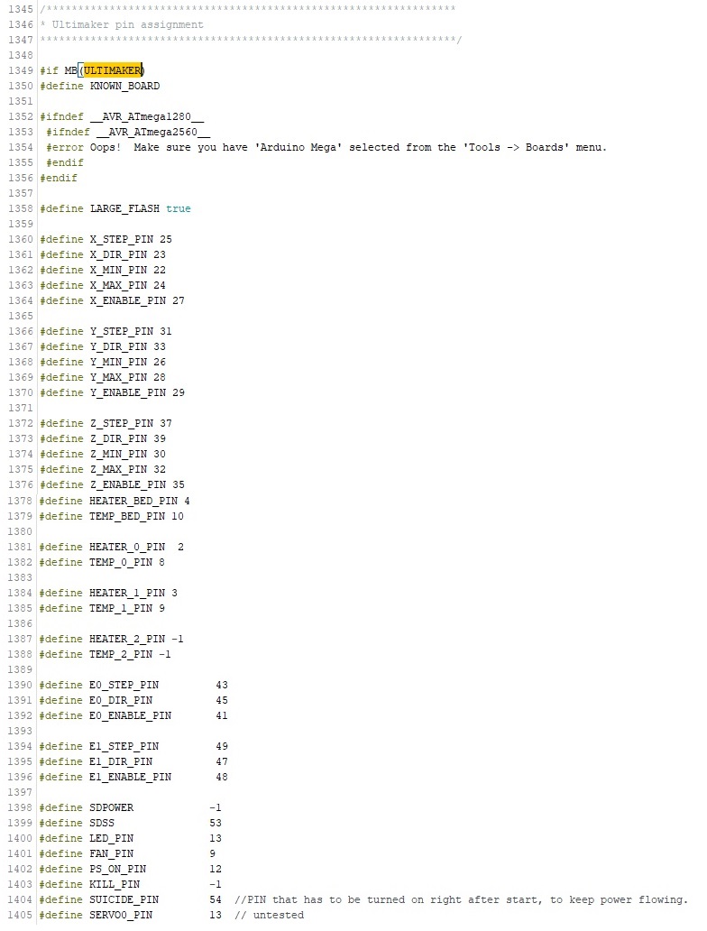

Good morning
I'm a new user, I have a problem with the Marlin firmware on my GT2560, I can not manage the fan control on the extruder, I tried to edit the file Configuration_ADV and Pins (see photo)
The same thing happens for the control of the external ventilation. Someone can help me.
Thank you
