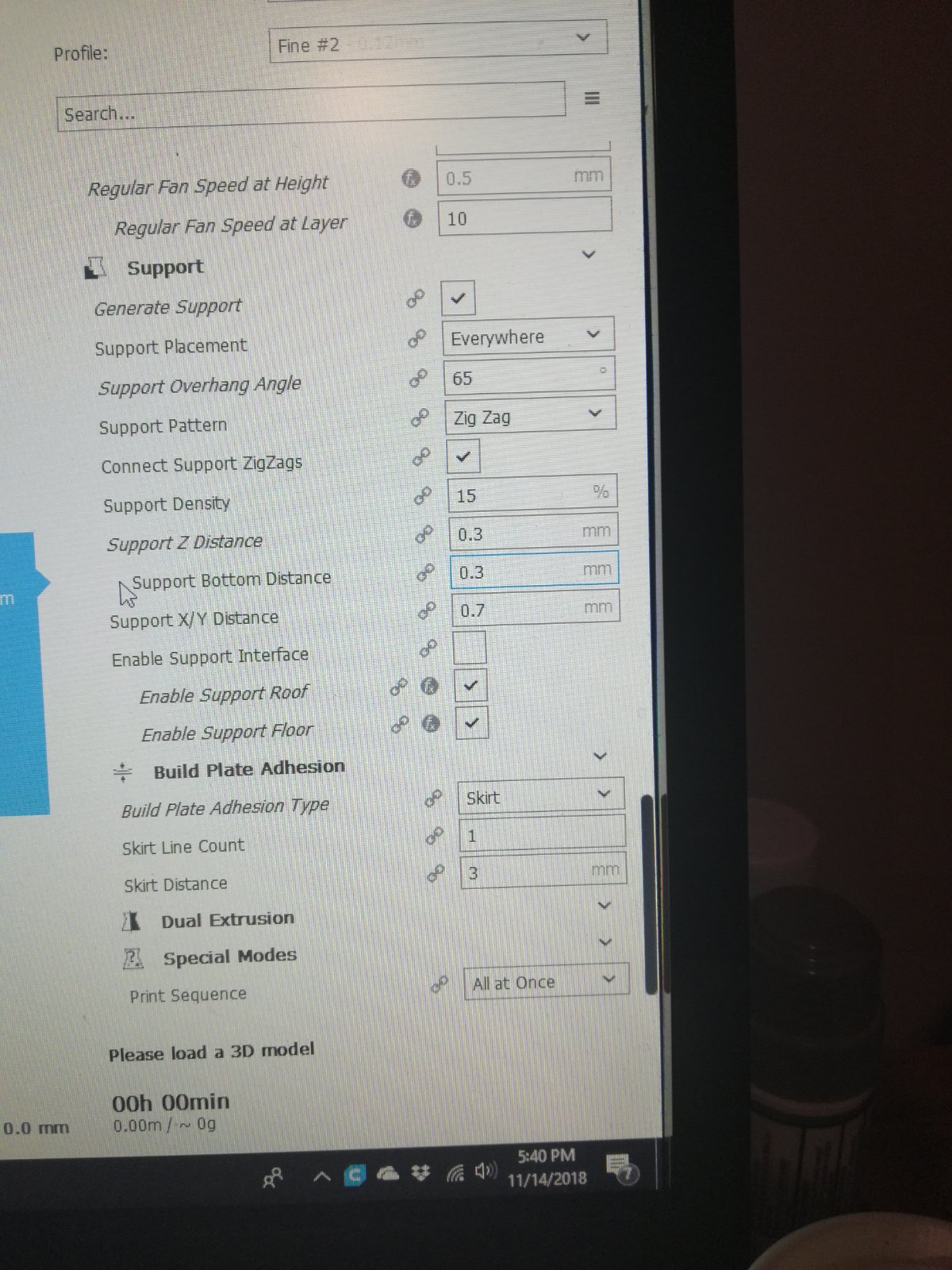

I purchased my first 3d printer and went with the geeetech a10. This thing was fun to assemble but I found a lack of cura resources/ or everyone else settings seemed different. So after a few weeks of trial and error I am going to post my researched settings so maybe it will help others find their best settings.
I did install the bl-touch auto level sensor and that did seem to help. But not entirely sure. I also don't need glue to keep the prints down for the most part anymore .
I am using pla plus /pro
