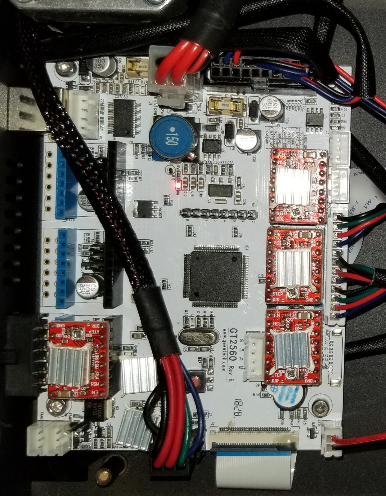

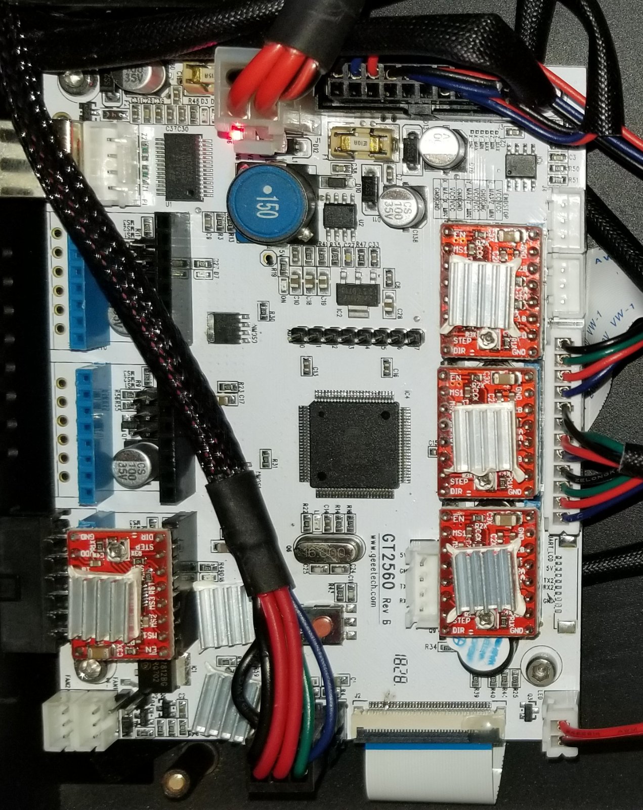

here are 2 pics of the board. The first one is on wall power and the other is on usb power.
when i plug in wall power only the console will not light even though the switch light is lit
when i plug in usb only the console comes on and everything seems ok but it will not heat the bed or extruder
when i plug in both the console comes on and it will heat the bed but the extruder will only heat a few degrees hotter very slowly. it will never come anywhere near operating temperature.
could it be the 15A fuse on the board? Thank you for any help

What worries me is what I saw in the first photo.
  1. No confirmation of operation of the step down 5V inverter.
  2. Two heat sinks at the bottom of the controller
The first may be caused by a burnt fuse,
The second may cause a short circuit.
Which fuse is responsible for what I will respond to you a little later. :roll:

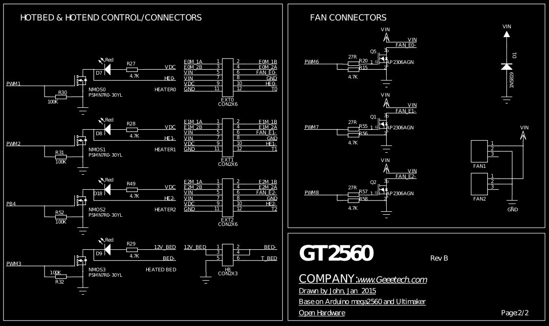

Which two wires in the picture lead to the heating element on the extruder? I want to test the resistance of the extruder heating element but i cannot figure which two wires go to it.
_kaktus_
Posts: 1259
Location: PL
Contact:
Re: LCD went out
Post by _kaktus_ »
Hi.
:mrgreen:
Extruder connector is black, angular.
You can check the layout of the signals in the diagram.
