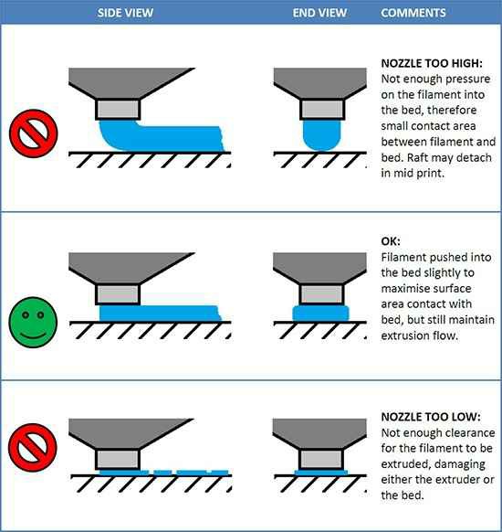

It seems you need to check the bed leveling at first.
Refer to this pic then adjust it again
