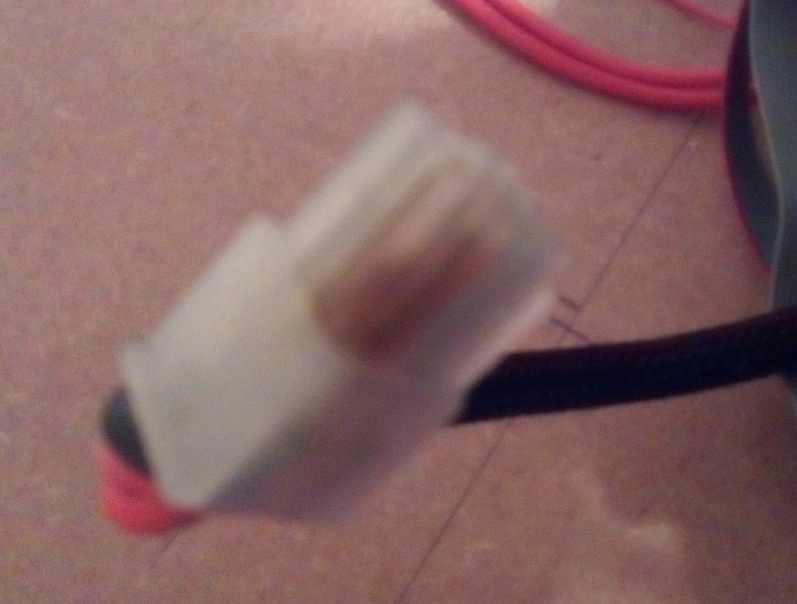

i have been keeping an eye on my molex after i saw this and its started to do the same thing!
WTF geeetech!?!?!?!
only thing ive been doing different is running the bed at 70 instead of 50.
I am no longer using this printer as it is not safe!
WTF geeetech!?!?!?!

Hi
This may be due to a connector defect.
The pins have loosened and do not provide a sufficiently strong contact.
You can successfully repair it yourself or replace the connector.
Follow the description in this topic.

apologies but i know nothing about electronics so that post made no sense to me at all.
Re: Power supply cable problem - GT2560 a+ nearly burned !
The point is to take the pins out of the body.
Clean the pins in the jewellery cleaner and finally gently squeeze them with pliers.

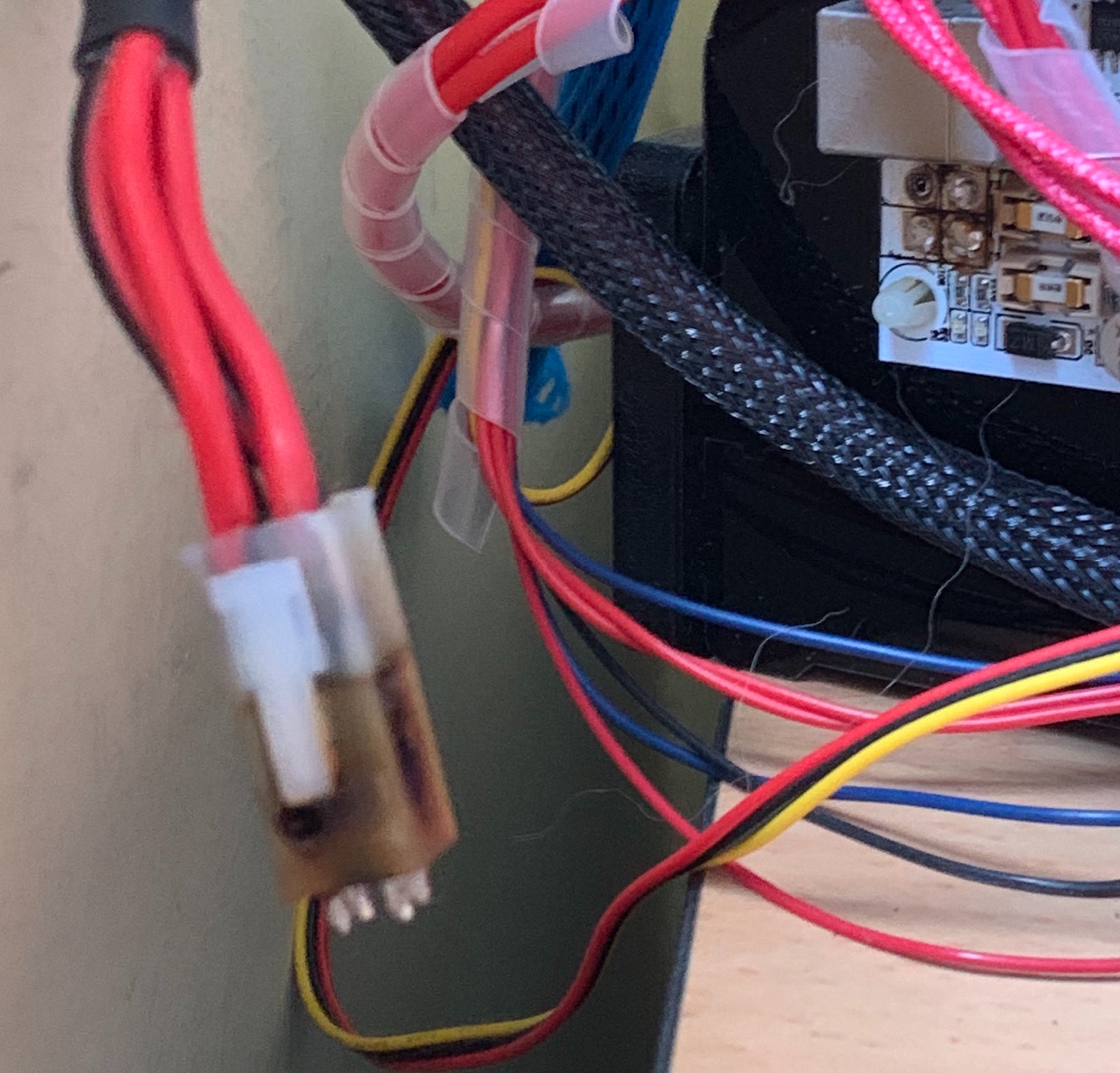

Hi, same problem. Printed loads, never touch PCB for many weeks. All a sudden failed after I am into half roll of PETG (230C extruder / 70 C bed). It was around 60 minutes into printing when problems started with burnt smell and printer lost power intermittently.
The socket totally desoldered from the board due to the heat.
Geeetech, hopefully you can provide a safe remedy for us, I am not that comfortable soldering the wire directly to the board as suggested by some on other threads/forum/facebook since mine actually heated till the solder melted.

Hi Geeetech. I traced the root cause to thermistor under the heat bed getting dislotch due to the loosen polyomide tape; thus the heat bed drew rose beyond your designed specs. The fuse didn’t activate, but the molex burnt.
This printer been working for about 4 months, into my 3rd reel of filament.
Perhaps you can advise a fix/upgrade for existing users to purchase before any incident happens. Or improve the firmware by incorporating a safety feature to alert (buzzle) if temperature falls despite supplying current to heating element.

Thanks for you feedback.Helicraz wrote: Tue Feb 12, 2019 8:53 pm Hi Geeetech. I traced the root cause to thermistor under the heat bed getting dislotch due to the loosen polyomide tape; thus the heat bed drew rose beyond your designed specs. The fuse didn’t activate, but the molex burnt.
They've upgrade it to 230W PSU.
