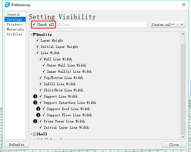

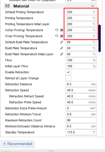

hi,
I have an A10m and seem that work fine, but when print two color with cura, the printer fail... print correctly only first layer whit two color, than it crash with fail heating error.
My firmware is 1.8 (may be... don't remembar exatcly now).
I have imported this profile but seem that is some wrong in my case.
If I use repetier host, two color printed work fine but I would use cura 4 that is more flessible and usable.
Can help mi?

Re: Cura json file for your Geeetech A10M printer
Hi,paolo.f
I think you can refer to these pic then set the temp of it to 200C
