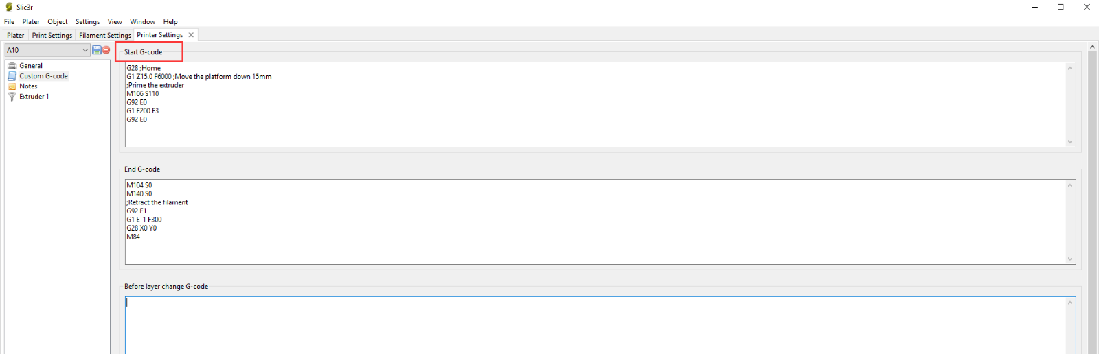

I think you can take a look on "Start code"
You can refer to these:
Code: Select all
G28; Auto home
G29; Auto leveling
G1 Y-3 F3000; Move the nozzle out of the print area
M190 S60; Heating the bed
M109 S200; Heating the nozzle
G1 X60 E9 F1000;Lines
G1 X120 E12 F1000; Wipe the nozzle

Oh......
I think you've misunderstood my words.
You need to add it to “Start Code”
Start code.png (60.22 KiB) Viewed 9606 times

Saw the Gcode start/finish boxes in CURA slicer for printer settings.
I wish I had the knowledge of how to use the code, so that when starting a print it sets the bed, and keeps the nozzle on far left so any oozing that happens doesn't land on the build-plate.
Since adding in the 3d-Touch sensor, it always goes to 125/125/10 and does a depth test with the level sensor, then the nozzle stays there as the bed and extruder nozzle heats up, and I end up with a little pile of goo on the bed, as well as sometimes it builds around the nozzle, so I end up with goobers as it starts to make its first print pass.
