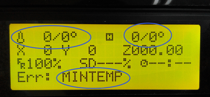

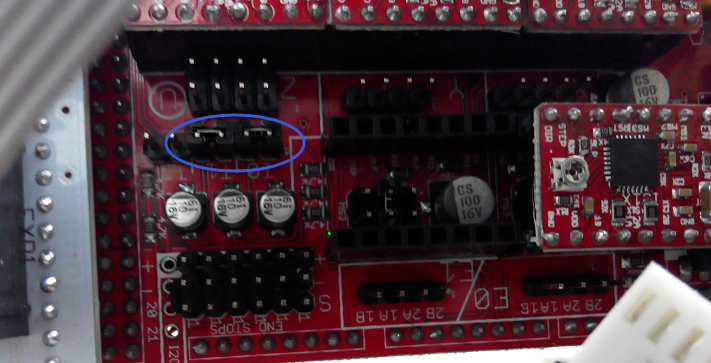

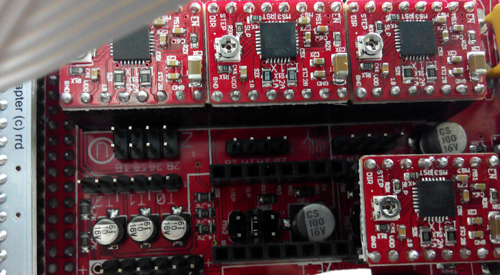

When you unplug the wires, the screen displays like this picture:

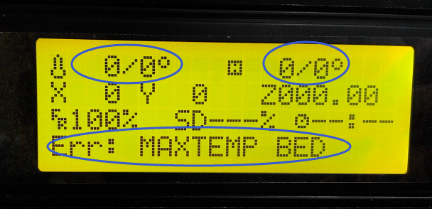

When you plug 2 jumper caps to to mainboard, the screen displays like this picture:
Check it.

With both thermistors unplugged the hotbed displays 0/0 but the hot end shows 22/0.
retaf99
Posts: 27
Joined: Thu Mar 19, 2015 10:17 am
Re: Err: MINTEMP LCD and Repetier-Host
Post by retaf99 »
Yes when I put jumpers on the pins as in the picture, both read 0/0, 0/0 and MAXTEMP BED

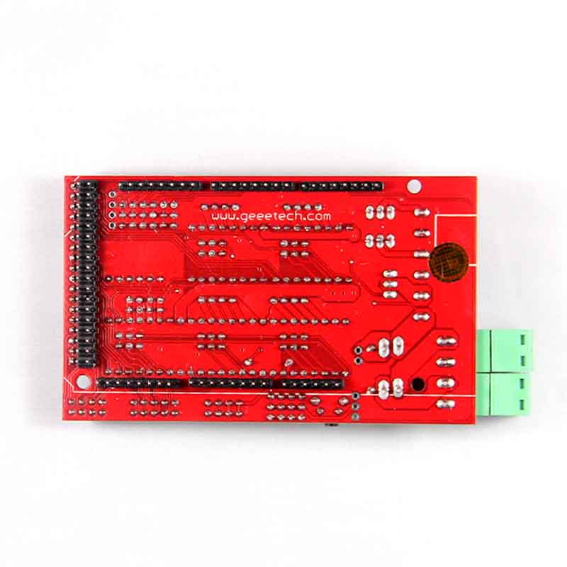

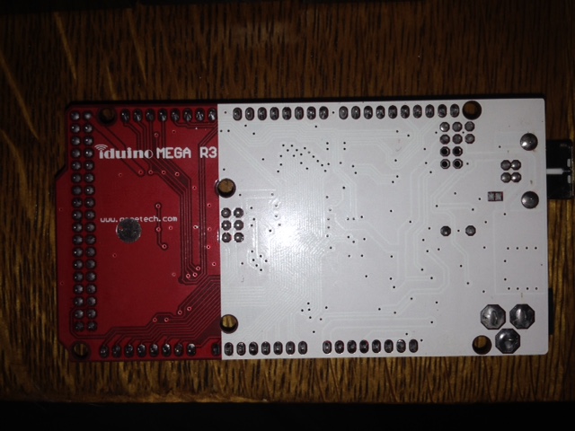

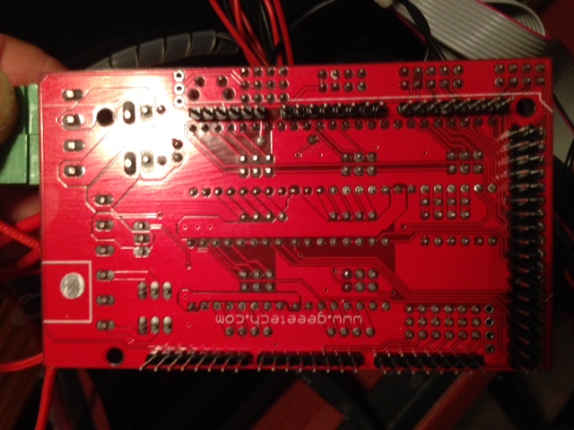

Please refer to these pictures and check if somewhere on the back side of boards is short.

I think I may have found the problem, a short in the connector. Checking now, and I will also check the back of the board.
retaf99
Posts: 27
Post by retaf99 »

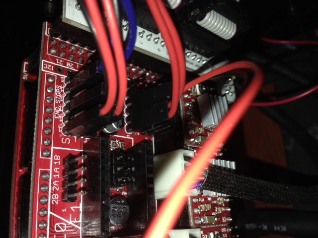

Connector seems okay. Checked boards, I didn't see anything that looked wrong but I have no idea what to look for so I took pictures. Still hae the error.
retaf99
Posts: 27
Post by retaf99 »
Now that the boards are back together both are reading 0/0, 0/0 and still Err: MINTEMP
