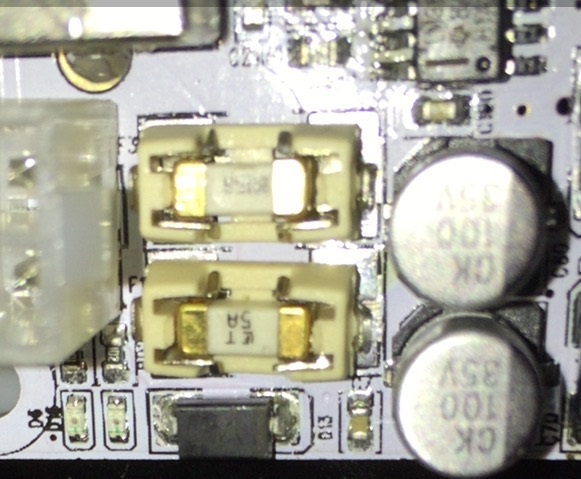

if i need to change the 2 fuses in the board, the ones of 5 ampere and 15 ampere , whic are the caracteristics ?
if i go to these page :
http://www.littelfuse.com/products/fuses.aspx
How do i find them ? pls i need help with these as soon as posible

hello
I need To remplace 1 of the fuses in the controler board, the one of 5 AMpere fuse.
ITS A littlefuse one , but i need to know which one is it , so i can buy a similar one andremplace it....
In this page you can look for the fuse , and if u can find it ,would u tell me Which one is it pls ? i need help with this im very frustated , because nathing is working at it should with my NEW printer so pls take a look

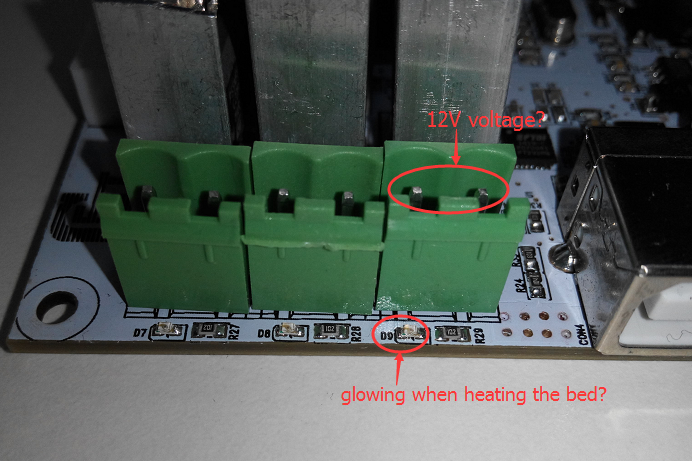

Hello i have mesured this voltage ... there is no voltage and the corresponding lead is not glowing i think thats the problem , but i dont know how to fix it ...
I have an other problem the Z axis cant move smoothly , it goes up but makes a lot of noice , but does not go down...
please can you help me ? this is its very frustrating

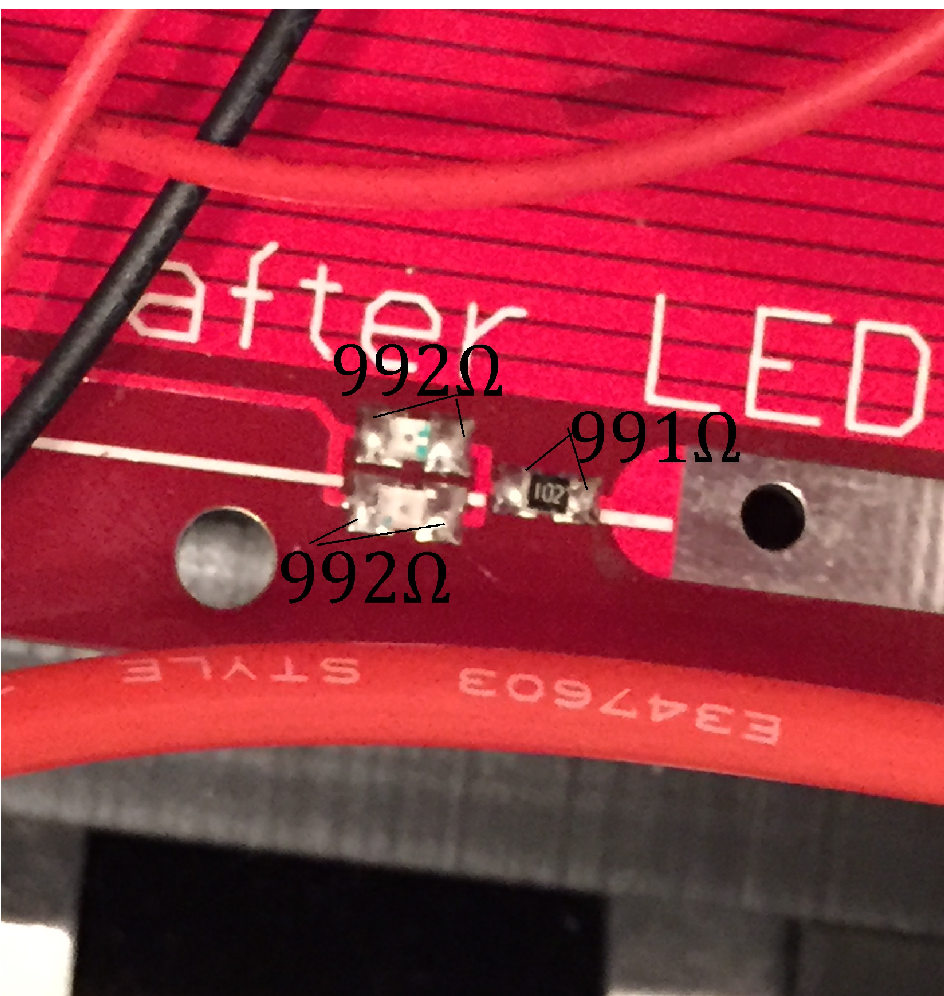

Hello i have mesured the voltage here... there is no voltage and the corresponding lead is not glowing when i put the heat bed to heat. i think thats the problem , but i dont know how to fix it ...
i mesured the resistence of the heat bed too
992Ω 992Ω and 991Ω
I have an other problem, the Z axis cant move smoothly , it goes up but makes a lot of noice , but does not go down...
please can SOMEONE help me ? this is its very frustrating
992Ω 992Ω and 991Ω
- i mesured the voltage... there is no voltage here
- QQ截图20150529114458.png (403.38 KiB) Viewed 11205 times
Re: i need help with Heatbed MK2a
hi,the normal range of MK2A is 1-2Ω.if you measure the resistance in acorrect way,it's obvious that the hotbed is open circuit.gastipincha wrote:Hello i have mesured the voltage here... there is no voltage and the corresponding lead is not glowing when i put the heat bed to heat. i think thats the problem , but i dont know how to fix it ...
992Ω 992Ω and 991Ω

this is wat i mesured
- rest.png (1.66 MiB) Viewed 11199 times
hi,this is a wrong way .please measure it as the picture shows.

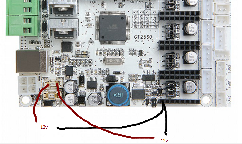

then,please check the fuse voltage on the mainboard.please refer to the following picture.
