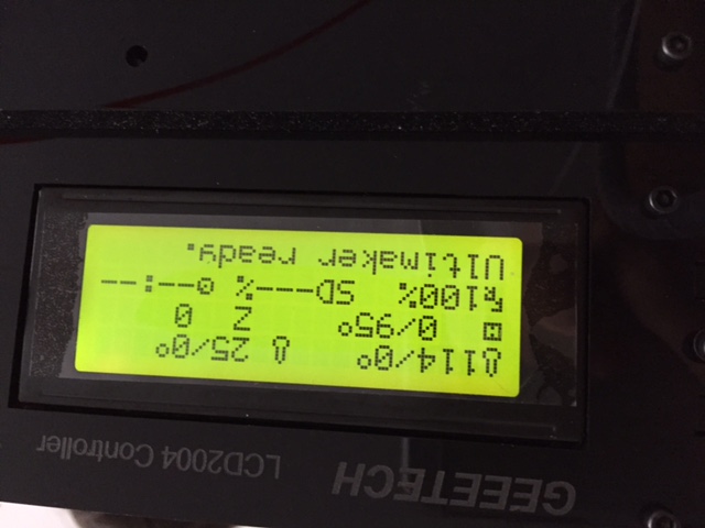

What is the LCD displaying? It would be better if you leave a picture.
And you should confirm the hot bed is connected correctly.

The hot bed is connected
the LCD is displaying 0/95 'c (i set 95 'C) but it stay on 0
I will leave a picture as soon as i can.

Even it can not heat, the LCD should not display "0/95". If it shows "0/0" when not heating, the hot bed thermistor is not well plugged or plugged to the wrong slot.

i think the problem is on the Control board GT2560... the ligth of the heatbed dosnt turn on but hte others do . should i try to touch the reset button ?

If LCD displays "0/95" when heating and "0/0" when not heating, you should check if the hot bed thermistor is fine, because when it is not well plugged, or when somewhere of thermistor is open circuit, LCD will display like that.
