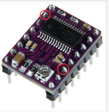

Connect these 2 pins if you want to turn switch No.2 on. As you can see in the picture:
connect MS2_VDD.png (150.61 KiB) Viewed 10712 times
XYZM
Posts: 46
Joined: Tue Apr 28, 2015 12:36 am
Re: From home to 200, but X axis only moved 100
Post by XYZM »
Ok. That could work.
