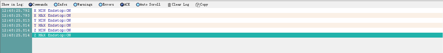

That's weird!I saw you said it's open when you home Z axis and input M119?Generally speaking,it appears "triggered" or "on" not "open".And have you done what i told you?
Have a look at the pic i post to see if it will help:

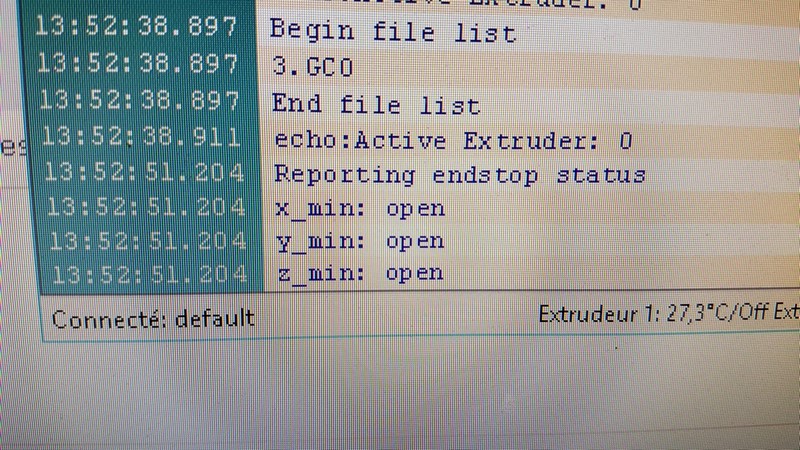

Could you plz attach a pic of the status after your inputing M119?Home your printer first
Re: Z home with autolevel
Posted: Mon Jul 11, 2016 8:01 pm
by qdshombre
M119 (Copier).jpg (176.07 KiB) Viewed 11576 times
Posted: Tue Jul 12, 2016 10:01 am
by William
qdshombre wrote:
Did your sensors of all the axis touch their own endstop???if they did,there should be "on" or "triggered" not "open".You haven't home them fully???If you didn't,manually move them to the endstop position then input the "M119" to see what happens.If you did,check the connection between the endstop and the endstop's connector on the motherboard.
Posted: Tue Jul 12, 2016 11:00 am
by qdshombre
04:59:52.037 : x_min: TRIGGERED
04:59:52.037 : y_min: TRIGGERED
04:59:52.037 : z_min: open
I have with X and Y, not for Z
