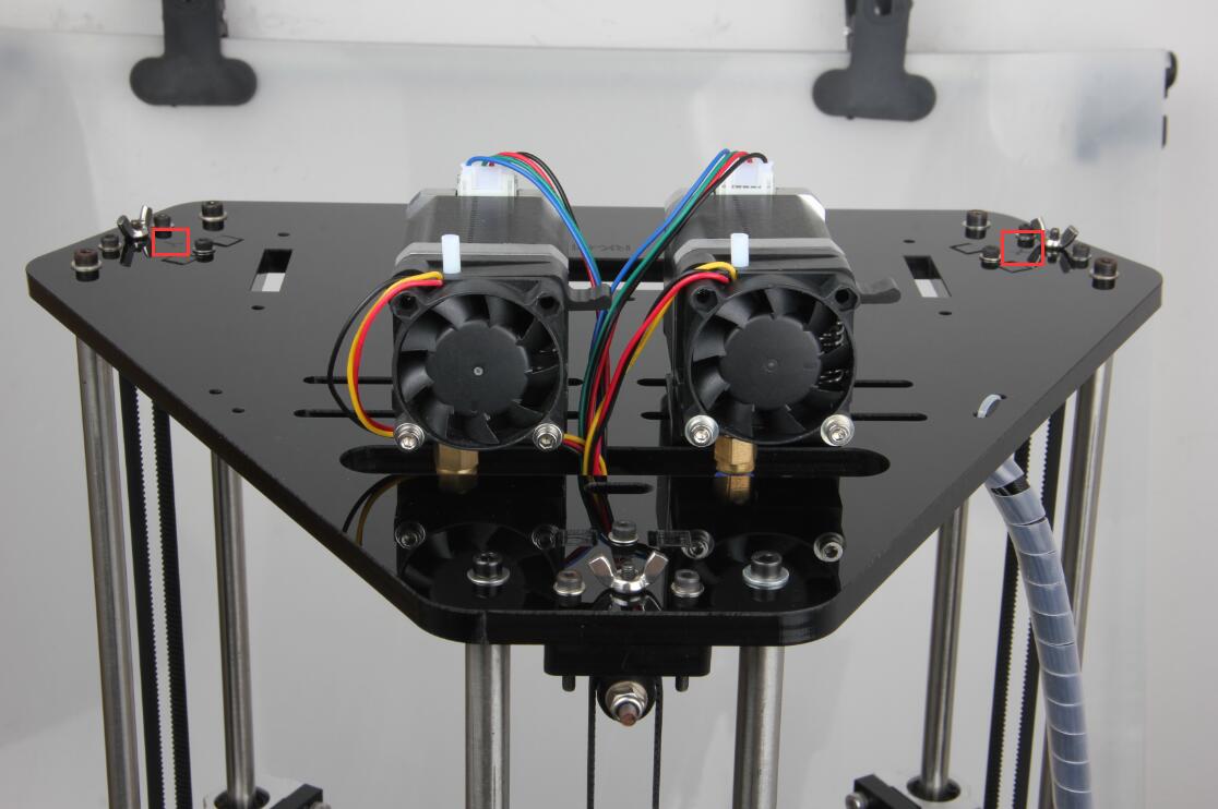

Re: G2s pro Z axis motor
You can find the corresponding axis on the top plate,see the red marks on my pic:
Thank you for the picture, I'm assuming that if I rotate it, and looking at it from the LCD screen, that the X is on the left of the screen, Y on the Right and Z in the rear. In my kit the bottom plate was etched with the X Y Z, but since the plate is symetrical and there were no clear directions on which way the etching side is supposed to mount. I'll double check my motor axis and switch axis (as well as operation) tonight and then reload a fresh firmware on the board and see what happens.
