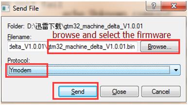

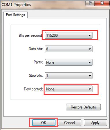

Re: The Restock 301(STM32 Pro Board) Firmware Burning Steps
Lami René wrote:Hello,
And for users on Linux Kubuntu 16.04 64-bit, how we should proceed and what software?
The engineer said you guys can find a similar terminal on Linux like the one on Windows,just need to make sure the baud rate and the protocol are the same as the pics show:

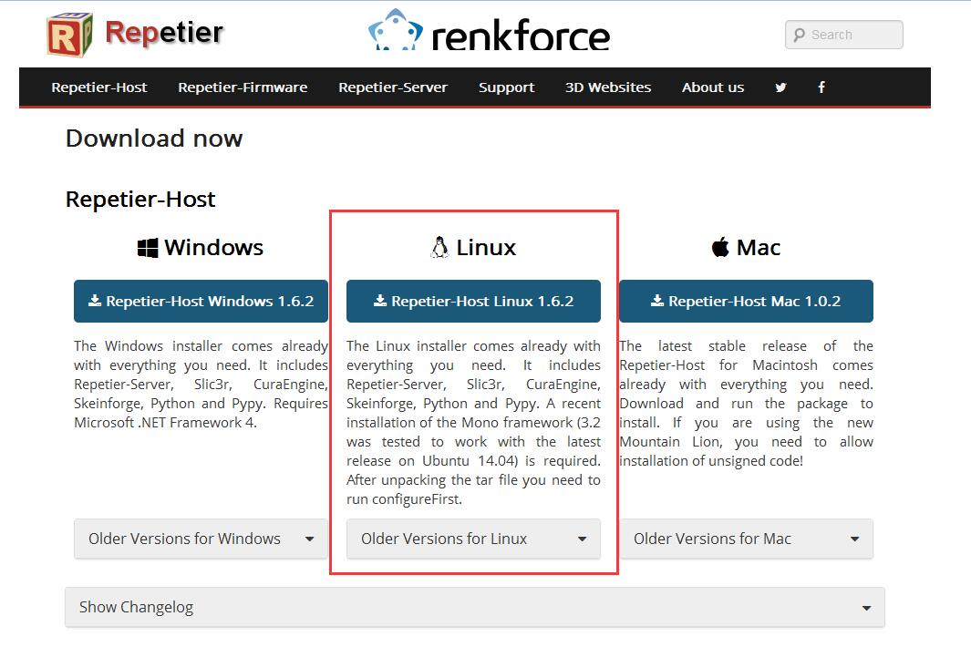

I guess « Operating system: Windows/Mac/Linux »
means the software Repetier Host:
Actually,you don't need to flash the firmware for 301(it can't be modified because of the close source),and it is well flashed when it leaves the factory.
So i guess it doesn't matter.

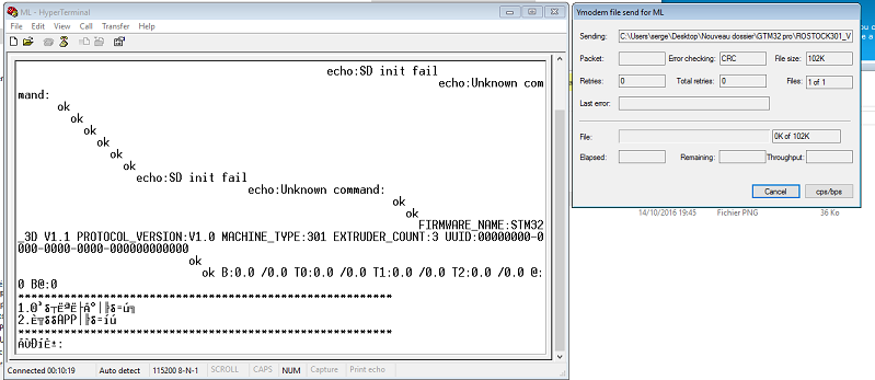

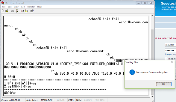

Hi.
I'm trying to burn new firmware on my 301.
All is Ok with the first part, but the final doesnot work.
When i try to send the new firmware with hyperterminal, the process does not work, and i get a time out.
No problem to burn the bootloader, and the no problem to connect with hyperterminal.
I tried to run it under admin mode, Windows XP compatobility mode, the printer alims off, then on, on various usb 2 or 3 ports, and it just does not burn anything.
My PC is a recent W 10 64 bits machine.
Look at the 2 screenshots :
