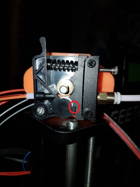

Hello raoulito9,
I have had the same problem with my Prusa i3 of geeetech.
The rostock and Prusa of geeetech share the same extruder.
My solution was to modify the cold end
I added a screw and cut off some plastic since the bearing couldn't get closer to the toothed wheel.
In the picture you can see in the red circle where i cut away some of the plastic.
- extruder mod.jpg (69.62 KiB) Viewed 16565 times
Re: rostock 301 filament extrusion too hard
Hi IM Frissen
My problem is addressed.
I bough some serious metal extruders from banggood, for 6$ each, and they just... work as expected.
No more skidding, and there is a screw , as you installed it, to give more or less force to the spring...
thank you for your photo.
