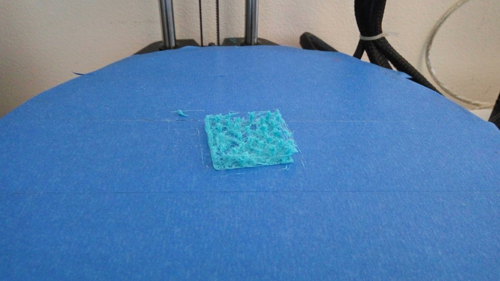

Hi.
The thing is that my new 301 can push enough filament in extruder to reach a good quality print.
With extruder 0 quality is terrible.
With extruder 1 and 2, it does extrude not even something to print...
I looked at the extrusion motor, and it runs normally, but the wheel skids on filament, because too much strengh is necessary tu send enaugh filament to hed.
I fear my head is not well drilled...
I own another printer, with 1,75 + 0,4 noozzl, and tryed to push filament with my hand, and it's way less difficult...
What could i do ?
What could i do ?

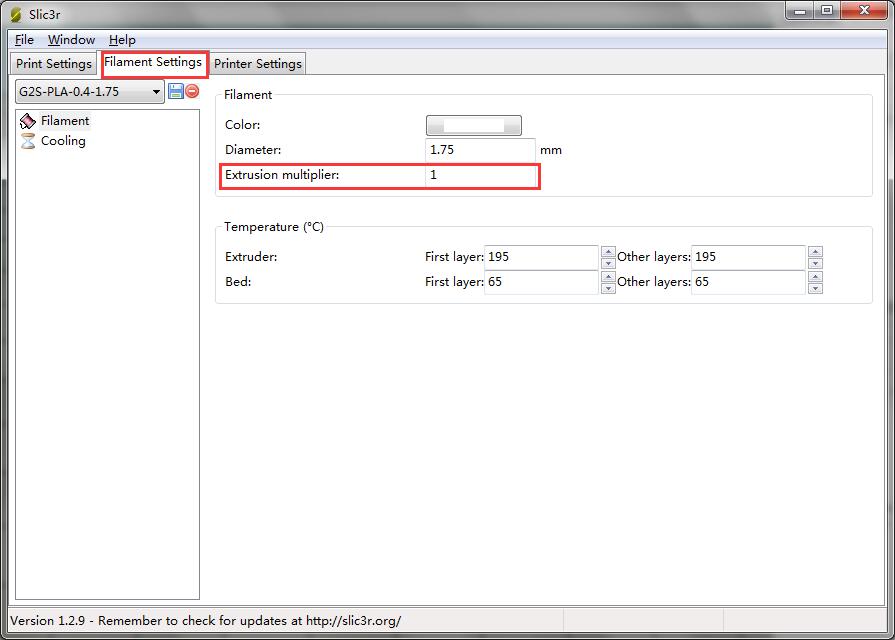

3.Increase the value to 1.1 in Slicer setting to see how it goes.

Hi.
Thank you for your answer.
I first tried to increase the % of filament feeding. No effect.
I had already removed extruder fans, ant i can see the extruder dent wheel is skidding on filament.
With my hand, the necessary force to push filament is way too excessive.
Head is not clogged but cant let pass enough melt filament...
I used to print around 200 °, and i tryed even with 220 °, does not change anything.

Hi, this is what i've done.
And i followed the entire unclogging process, hoping it would help, the re plugged PTFE, pushing them to max depth.
Nothing new, the toothed wheel slips on the filament, and just a little amount of plastic is extruded. It gets a little better if i help the motor, pushing strongly with hand.
My other printer (1,75/O,4, standard nozzle) does not need that much force to extrude.
Is it normal ?
I fear my diamond head is bad drilled; someone else on this forum had the same issue.
Is it frequent ?
I'm really upset.
Thanks for advices.
Is it normal ?
Is it frequent ?
I'm really upset.
Thanks for advices.

Also,what is your "Extrusion multiplier" value in slicer?
