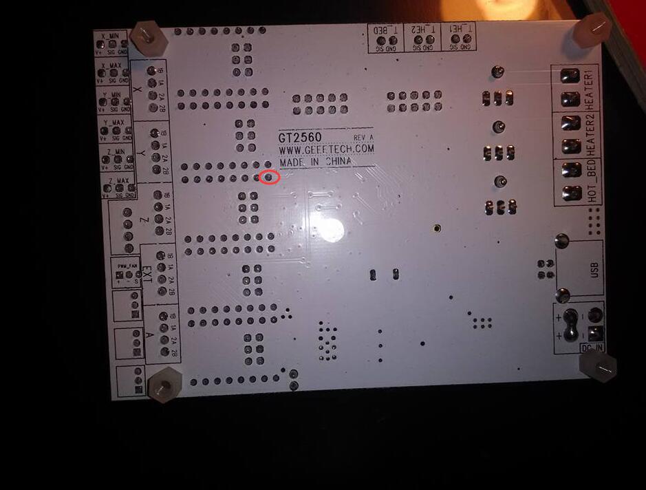

Take some clear photos of your board's back and front,i wanna see if there is a bad soldering at the "DIR" pin of Z axis.

Re: Z AXIS BLOCKED in one direction
Pierfrancesco wrote:Image
You can try soldering this spot in the picture again if you have a tool.

I will try to solder... Yes, I reflashed firmware many times

Nothing happened, always the same... :(
