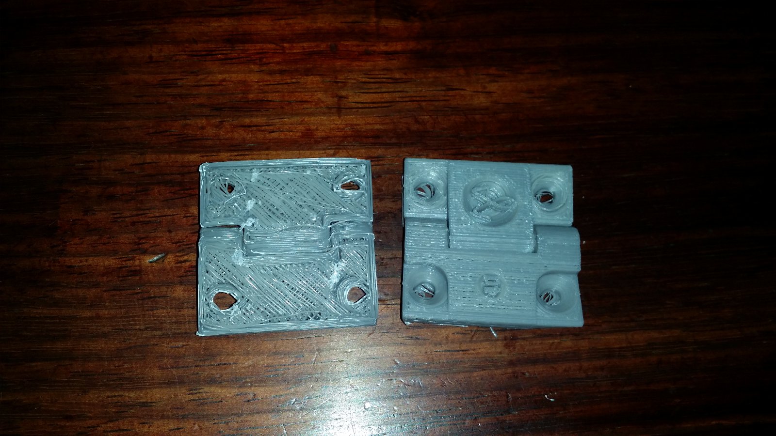

Can i just ignore the clicking or popping sound? By the way my first layer was a messy. How do i solve this 1st layer messy. See my attached photo. Printing in abs at 0.2 layer height.
1st layer height

keyser187
Posts: 28
Joined: Mon Jan 22, 2018 9:28 am
Re: Print quality on i3 pro W
Post by keyser187 »
What speed are you printing at? Also what is your first layer speed? Because that makes a big difference to your first layers sticking
