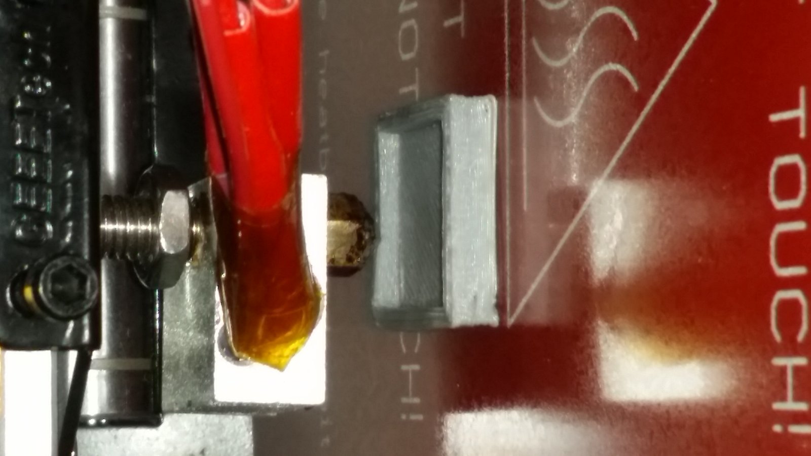

Can someone help on the print quality? The print on external wall layer have lots of gaps. Im using a 0.3mm nozzle. Does changing the nozzle to 0.4mm help? How to improve the print?
I have attache a photogrpahs of the print.
- Any advice?
- 20180806_220632.jpg (239.55 KiB) Viewed 13901 times

I calibrated the z axes and the quality it improved a lot more!!! Thanks for the advice.
But now im hearing clicking sound from the extruder on some part of the print. I suspect the layer and nozzle could be too near. Any suggestion?
See my print.
See my print.
- 20180809_004555.jpg (157.2 KiB) Viewed 13840 times

Re: Print quality on i3 pro W
Derekchong wrote: Thu Aug 09, 2018 2:31 am I calibrated the z axes and the quality it improved a lot more!!! Thanks for the advice.
The printout shows that one page is more pressed against the work table.Derekchong wrote: Thu Aug 09, 2018 2:31 am But now im hearing clicking sound from the extruder on some part of the print. I suspect the layer and nozzle could be too near. Any suggestion?
See my print.
This may indicate that the work table is not level enough.
I expect that when the printer was doing that part of the printing, one could hear a click in the extruder.
You may want to try applying washer to the spring into extruder to increase its pressure.

I will try to put a shim in the spring as suggested. What do u mean my work table is not level? Is my print bed not level that lead to the clicking sound?
Hi
work table = heat bed
I mean that the levelling procedure has to be done very precisely. As good as you can.
