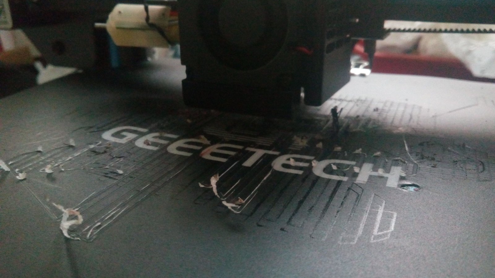

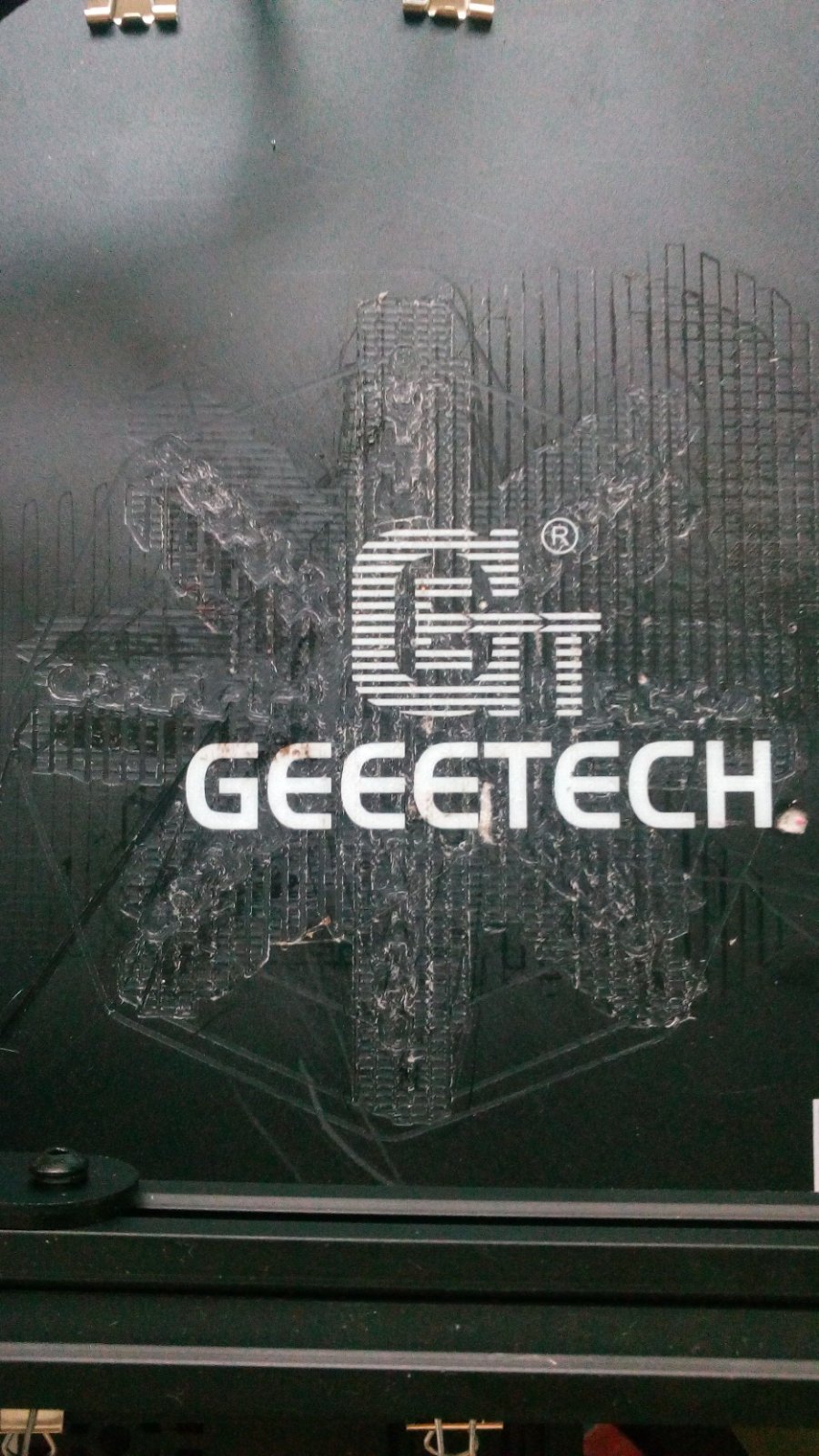

P.S. -- Few prints of octopus & A10M Fan Cover cannot raise Z-axis to above 1 mm, despite over 1 hour of printing.

- White Nylon.jpg (147.13 KiB) Viewed 24815 times
- Octopus Start.jpg (207.57 KiB) Viewed 24815 times
- Imprints.jpg (275.8 KiB) Viewed 24815 times

Hi, from your screenshot, the position of the z-axis is too low, causing the distance between the nozzle and the hot bed to be too close.

The octopus imprint on heat bed was from Z at 0.4 till 38.4 mm after 2 hrs 23 minutes of printing
(nylon was melting at extruder) but Z cannot rise above 1 mm.
What caused this please? Thanks.

My query is why extruder cannot rise up above 1 mm from hot bed despite 38.4 mm shown on green LCD screen.
No 3D octopus was printed except only white nylon imprint left on hot bed, i.e. Z-axis cannot rise above 1 mm.
Same with A10M Fan Cover using black nylon filament.

No clogging found when either White or Black Nylon filament was selected for 3D printing,
since they were oozing out from single extruder while reaching 260 deg C.
In fact, stringing of black PA occurred during printing of A10M Fan Cover as 2D iso 3D.
Query is how to overcome 2D printing to realistic 3D printing extruder cannot rise up above 1 mm

Yes, both mini Octopus and A10M Fan cover on BOTH slic3r and Skeinforge produce same 2D results
