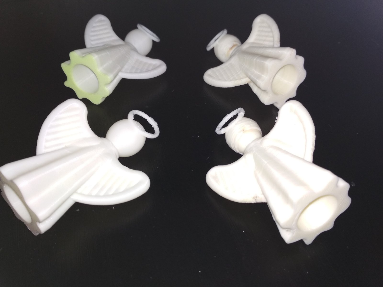

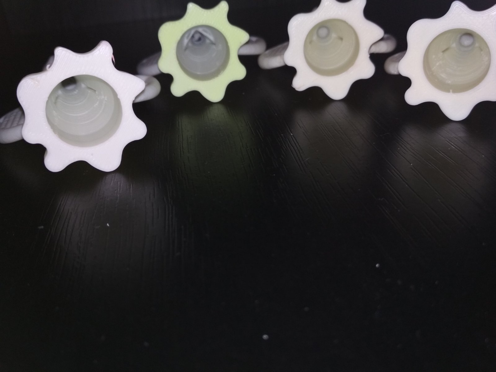

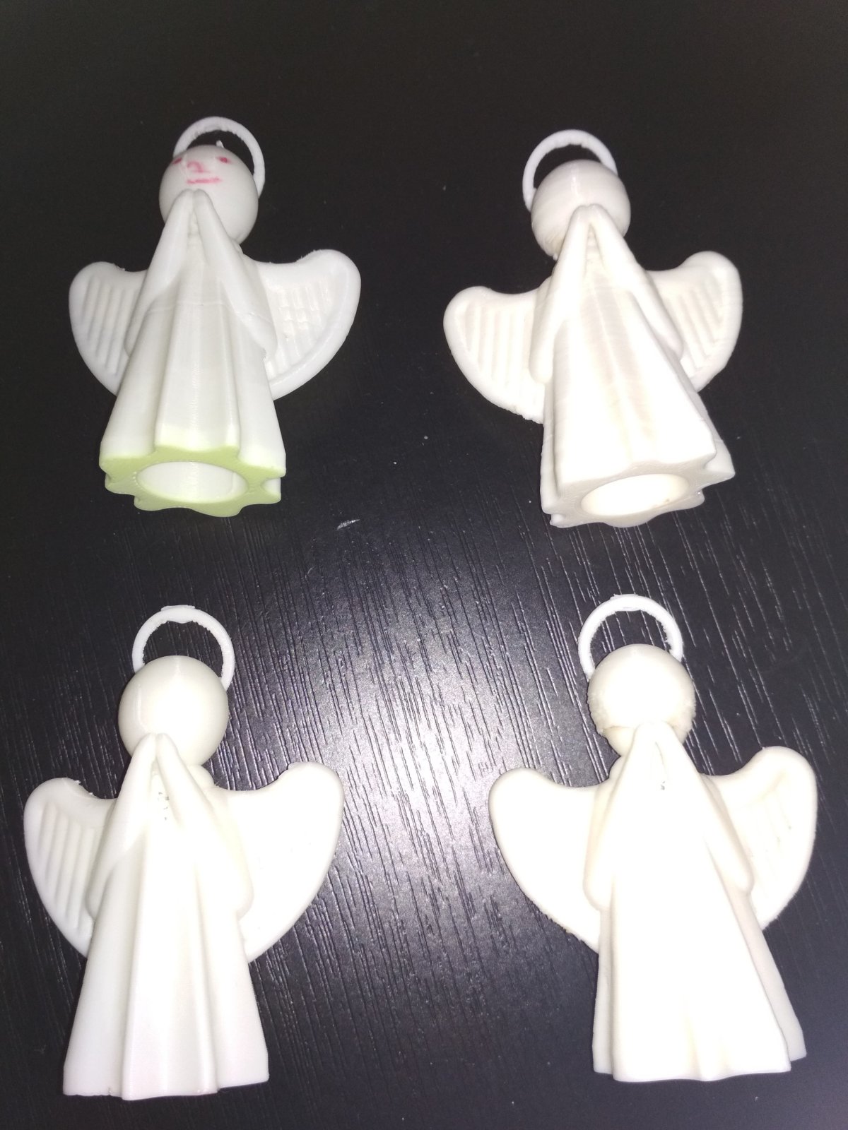

Testing print of angels from here http://www.thingiverse.com/thing:1864269
Photos arrangement
Vase adaptive FULL, standard mode adaptive FULL
Vase adaptive, standard mode adaptive
I know, there are problem with head. Maybe slower printing about 10-15mm/s will help it.

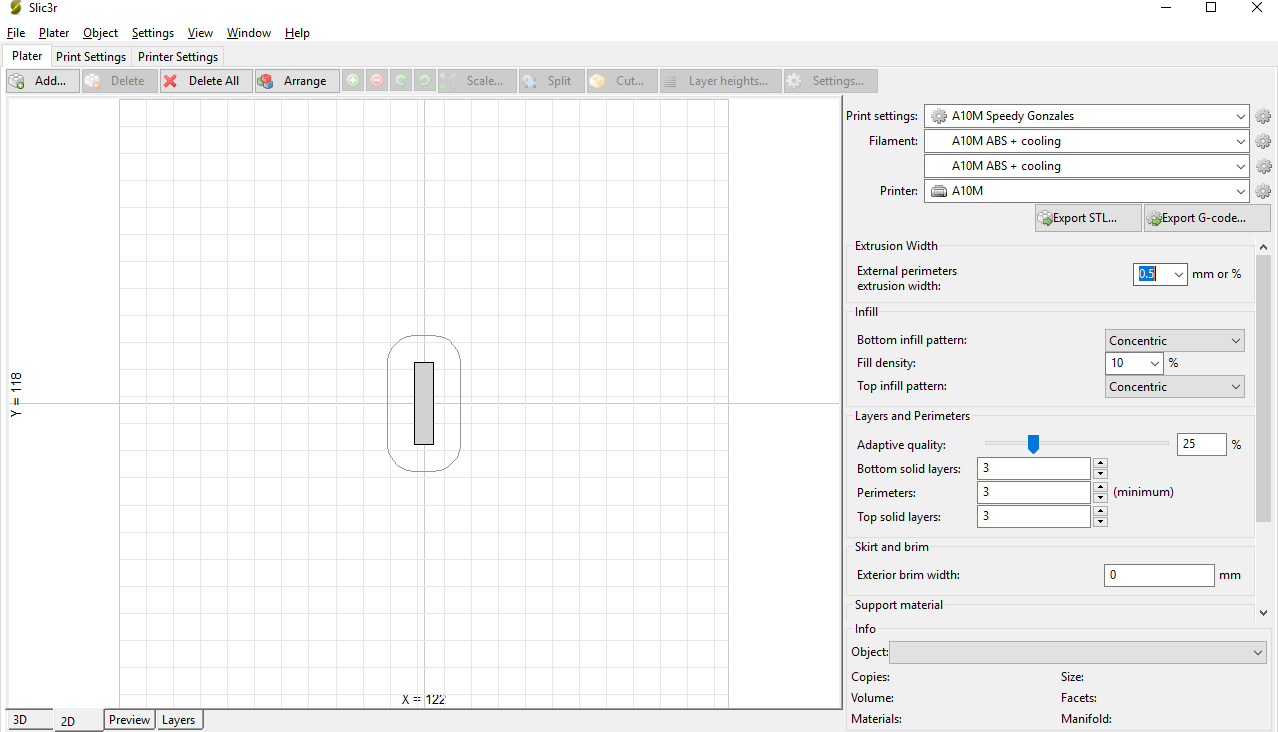

Profile is updated. Retract speed is more fine tuned and added Speedy Gonzales profiles (printing up to 120mm/s), which are still under development
The most of printing time is not printing moves (except vase and simple large pieces), but non-print moves and retractions. I was play with printing speeds up to 160mm/s (yes, with my A10M), but it save time like that with little worse surface finish.
30 mins... 20 min
3h 35m ... 3h 25m
For general work with this slicer choose 2D display due slowness with 3D in this software.

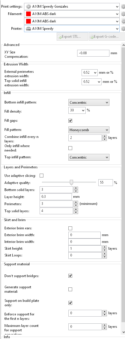

Updated profile. Added 2 speedy profiles, Speedy Gonzales for higher quality fast prints and Steve McQueen for fastest printing avaiable. Basic HQ profile updated too. Printing speed could be up to 3 times less, in dependency of complexity. Profile updated in the first post
Attention, you need probably tight your feeder springs. Steve McQueen could saw filament.

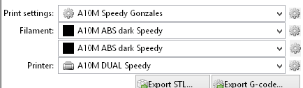

Dual Colour profile and profiles for "touched" and "untouched stocks" printers. The difference is in the Extruder feed speed, untouched is 340 steps/mm, touched 430 steps/mm. Untouched is marked A10M, touched A10 (but attention, there are high retract amount, which is not optimal for plain A10).
Dual colour print is without cleaning tower with little addition - trash bin to clean extruder. See http://www.thingiverse.com/thing:3525097 But attention, the STL model is bad. I have corrected one and Gcodes to print on A10M with untouched and touched printers (see steps resolution). Ex340steps is for untouched printer, ex430steps is for extrusion multiplier about 1.0.
The Gcode is featured for 258°C print with ABS and slow HQ type motion to make super strong thing. So you now know, that Speedy profiles are partially useable to cooperation with HQ profile to make ABS stronger. I use Gembird ABS which does not smell and is of course cheapest in my country. Yes, black and blue make little "asphaltic" smell, but a little, wife does not make protests. Because Titan extruders are not enough to transfer power from geared motor to filament (see http://www.geeetech.com/forum/viewtopic ... 26&t=68505 ), speed profiles are limited to volumetric speed. Whatitdoesmean? Thin layers are printed in higher speed than thick layers. A10M due filament mixing path in hotend need much more force to filament. Geetech know about it, because they install Titan extruders instead of MK8 from plain A10. So if you have A10, you can try my profiles with slightly less retraction (About 5-7mm). Note that high temp printing need substantially more retraction length and other settings than ordinary temps.
Why 258°C? Because 260 is unstable and more than 260 is unavailable due some hard coded limits in Marlin code. But if you want to use this temps, you need to change limit in Control section of menu, default maximum is 250°C. And save it of course into EEPROM.
Note that Speedy Gonzales profile is good for everyday printing now with slightly less strong. Steve McQueen is for highest speed, but it is more less strong. HQ profile is for nice and strong.Dual colour print is without cleaning tower with little addition - trash bin to clean extruder. See http://www.thingiverse.com/thing:3525097 But attention, the STL model is bad. I have corrected one and Gcodes to print on A10M with untouched and touched printers (see steps resolution). Ex340steps is for untouched printer, ex430steps is for extrusion multiplier about 1.0.

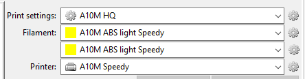

New and cleaned. Near all my prints are done with Speedy Gonzales profiles. New Fatty profile derived from SQ and HQ, for stronger prints than SG. Maybe will be abandoned, but I was need it for one faster and strong print.
As Summer temperatures goes high, profile temps goes lower. Some like winter and summer profile needed?
Important change - it has temperature profiling by layer height. Begin with first layer for good adhesion, then lowered for fine sharp details, then back because we are from bed, and finally high other layer temperature because we are far from bed. Need more tuning, but it heavily depends on your enviroment. There are calibrator profile too, where you can test filament temps, see gcode configuration for more knowledge.
Here are config bundle and copy of all INI files from slic3r user home directory.
