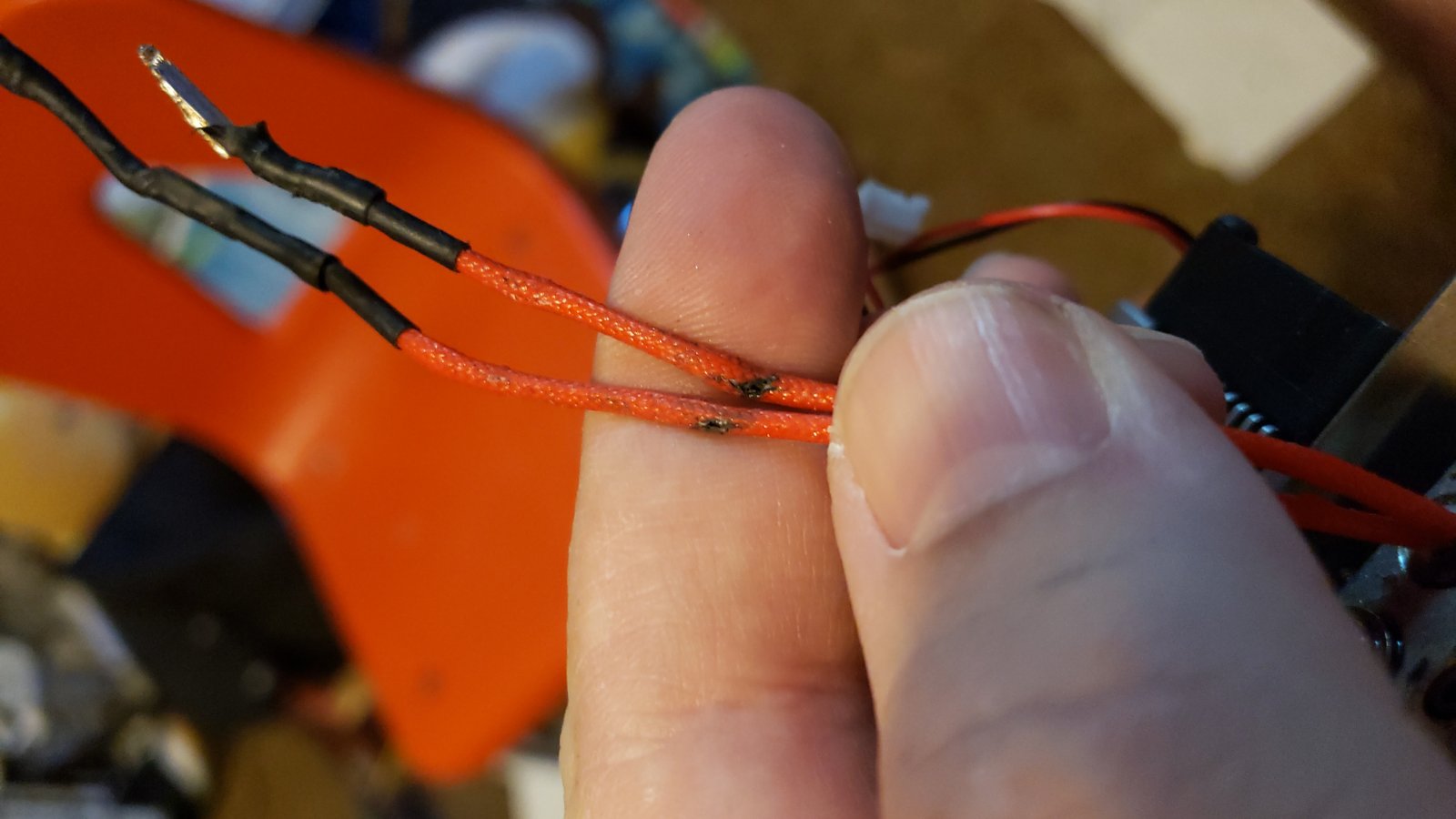

I pulled it apart again this morning in preparation for installing the replacement parts and I think I found the source of the sparking.
Re: Broken Printer - What to check?
Posted: Mon Sep 02, 2019 3:55 am
by Matsubaa
The undocumented cable routing has to be threaded through a very particular way so nothing rubs on the X-axis, that's turned out to be my baseline issue.

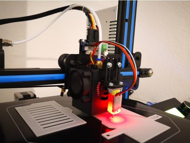

My new replacement part immediately burned through the insulation rubbing on that same edge. I figured out what was wrong, re-routed the cords and shrink-tubed the bare wire spot. Currently I'm printing a new mount for that extension board so nothing has to thread through/around the carriage and it'll all plug in on the front side.
When it's done, it'll look something more like this:
a10 board working.jpg (47.63 KiB) Viewed 6098 times
