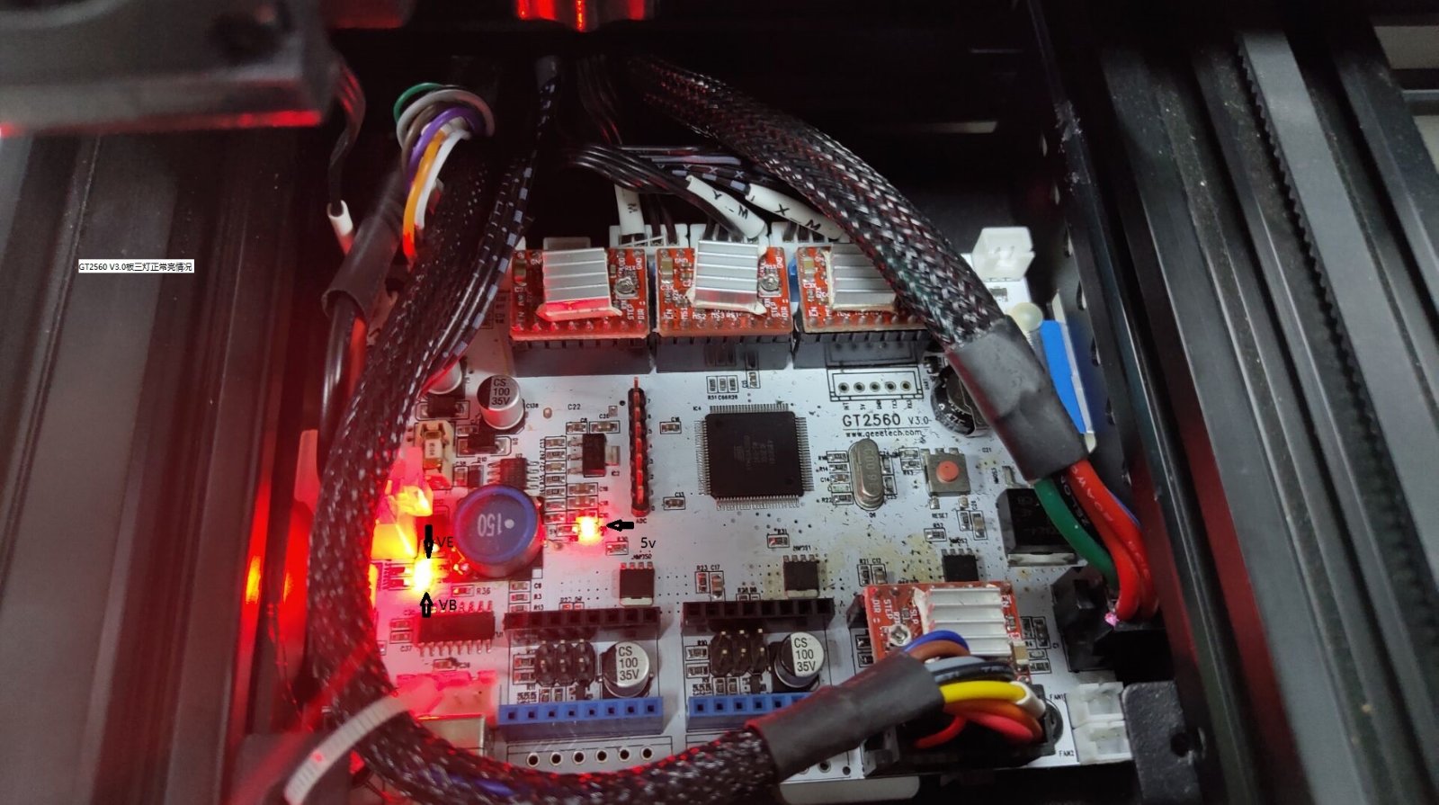

Hi,You can check if there are three lights on the motherboard when the printer is turned on normally.
You can refer to this: I hope this can help you.

I've dug in and I have only the light labeled "12VB" (hard to read the silkscreen) lit up. Hopefully that narrows down the candidates for the short?
Honestly as I got in there, I see that the 15A fuse wasn't seated properly and the 10A fuse appears to have some kind of scorching on it.I'll clearly be dusting it out and replacing some fuses at the very least.

Does anyone know the significance of the 3 lights? I assume they all mean something different and wonderfully diagnostic but I found no documentation what they actually mean.

Hi, If the three lights on your motherboard are not lit,Matsubaa wrote: Tue Aug 27, 2019 7:11 pm Aside from the fuses, I don't know that anything's wrong.
the printer will not work properly.
In the case of the VB reaction hot bed,
the VE feedback is the hot end and other cases,
and the 5V lamp feeds back the case of the LCD lamp.

So for clarity's sake -
The 3 lights should be on, regardless of the condition of the fuses in question.
I've blown 1 fuse (10A) pertinent to the heated bed which my 0.2 Ohm multimeter measurement says is definitely shorted.
Am I definitely going to need to replace both the mainboard entirely and the heated bed?
Or am I definitely replacing the shorted-out bed and conditionally replacing the mainboard pending the fuse replacement?
Re: Broken Printer - What to check?
If fuse is blown out, most likely your mainboard survived. Check if bed clips are causing the short, it is well known problem with them.
