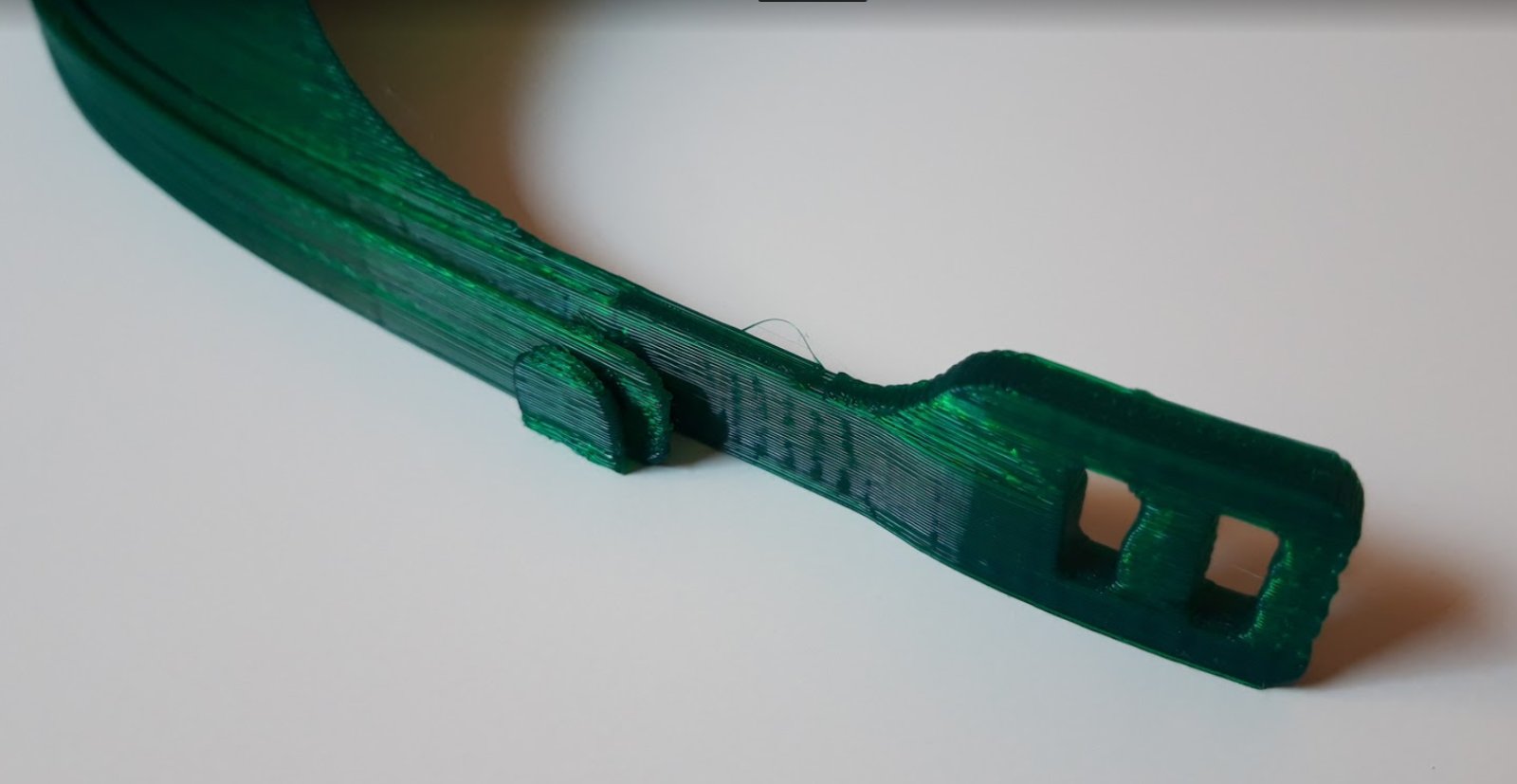

Test 9:
I changed the filament and I used the brand Smart Materials, Smartfil. The first piece it was very good with any problem but in the second I heard the blockade in the feeder gear.
The problem where I had parts without material had been solved with this new material. Thank you

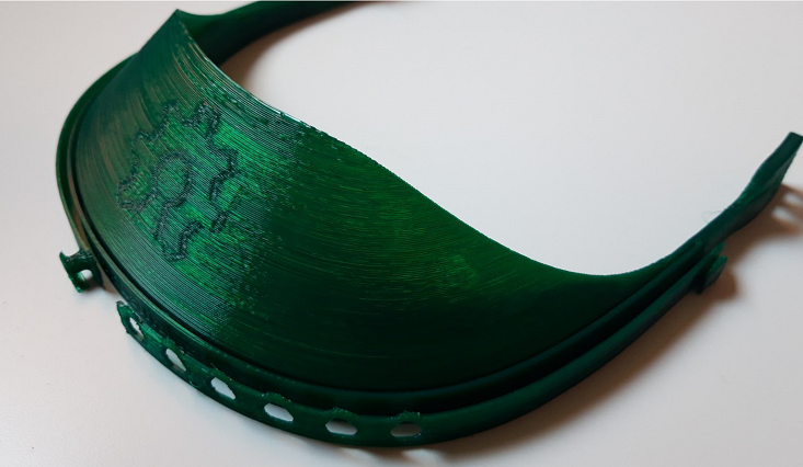

Test 10:
Nozzle temperature: 215 ºC
Retraction distance: 4,6 mm
Retraction speed: 60 mm/s
Layer height: 0.28 mm
Print speed: 40 mm/s
Fr 85 %
Pieces: another face shield and one retractable push button.

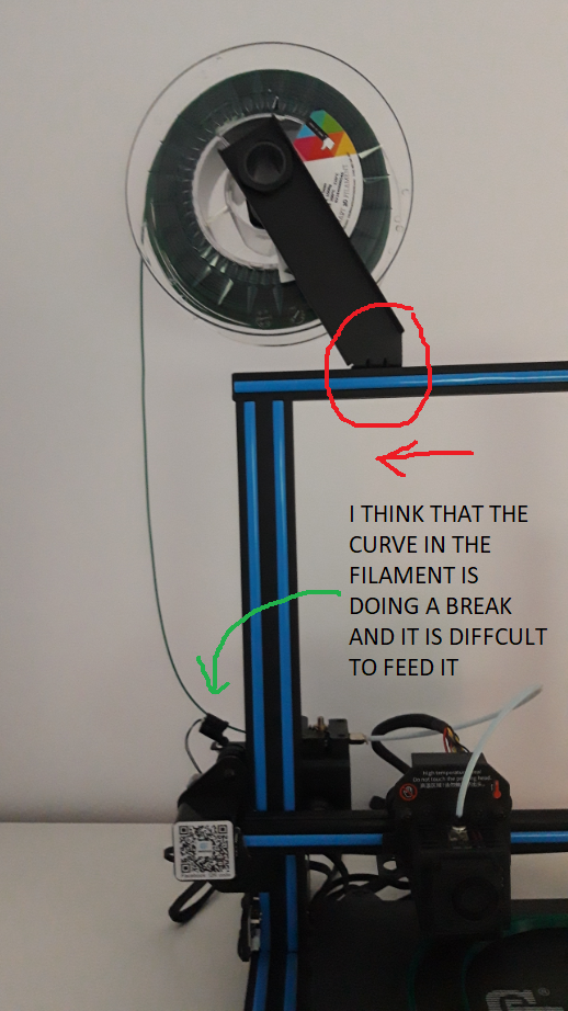

10.1
10.1

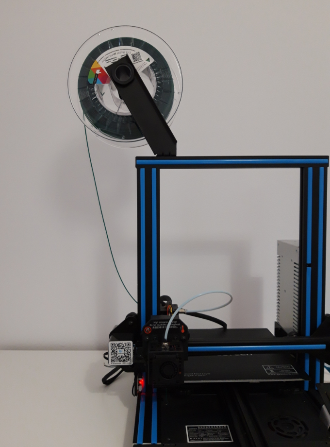

I had the support of the filament wire a little right and I moved to the left becuase I think that the filament curve is doing a break.
10.2
10.2

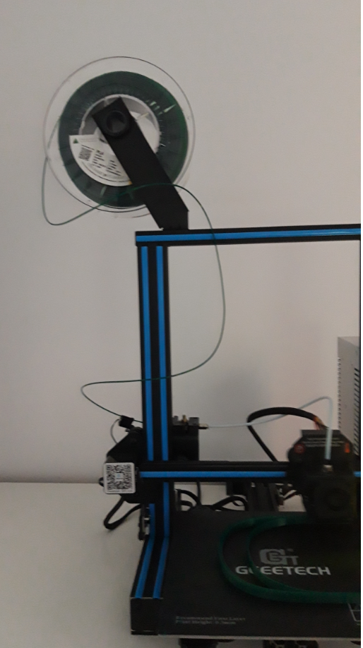

But I still had a blockade and I unwinded manually the filament and I had not a blockade. In the following image you can see the filament not tight.
10.3
10.3

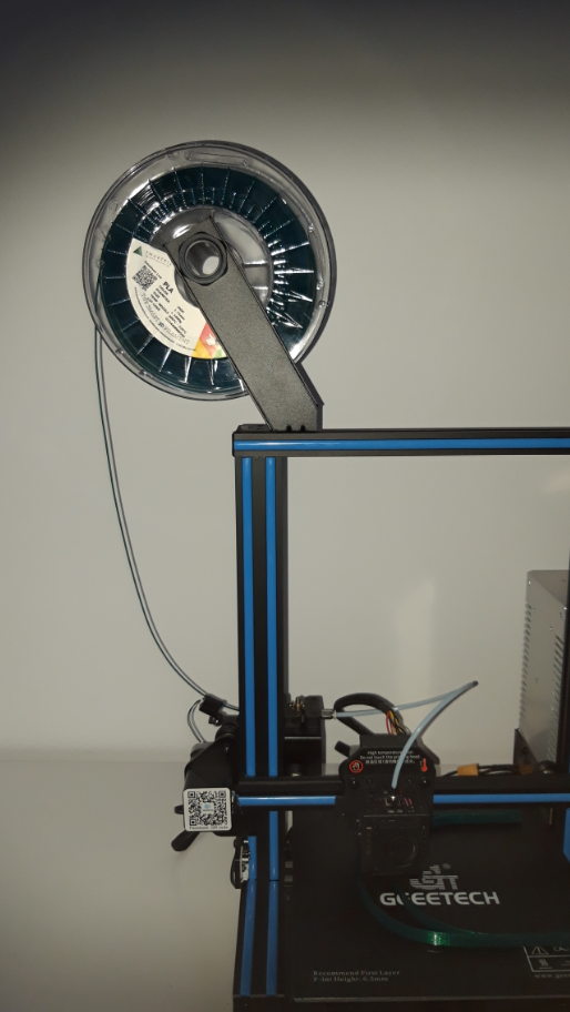

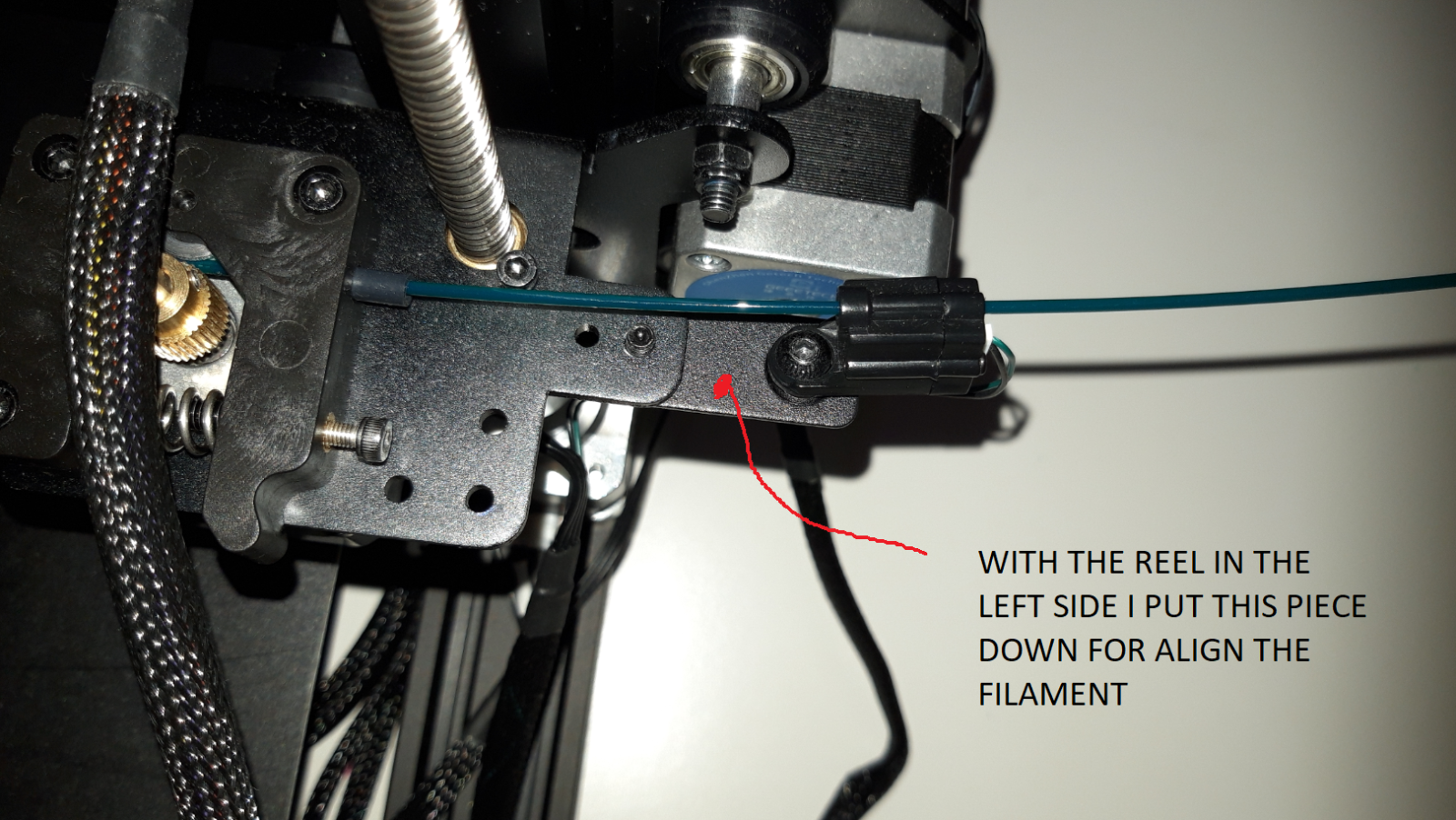

Finally I decided to move the reel to the left side as you can see in the following image (in this position I have no problem)
10.4
10.4
10.5
10.5
With the reel in this position I have less blockades but sometimes yes. With the reel in this position I can not do tall pieces, I think that the feeder gear is pushing very fast and can not move the reel quickly.
What do you recommed to solve this problem? If you prefere I can start new test with your print parameters

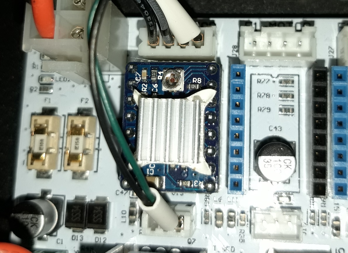

I have this driver
1. What is the name of the driver?
2. What voltage range is recommended?
3.Do you know where is ground here?
Thank you
