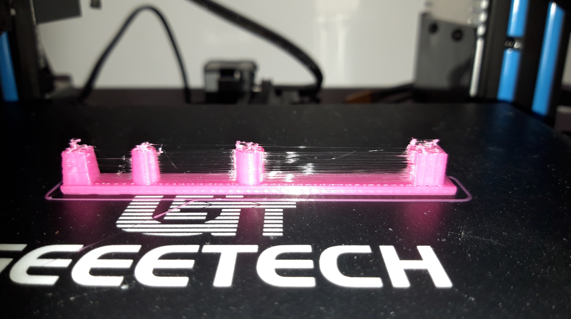

I have bought Geeetech A10 but I have not been able to print practically nothing. In the middle of the print or before I have a blockade in the nozzle and I can hear how the extrusor gear is making noise because he can not push the filament.

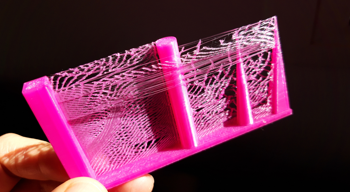

If I put a retraction distance of 0 mm I have no problem but I have strings and hairs as you can in the following image.
(see image A) If I change the retraction distance from 0 to 2 mm I have a blockade after the machine runs.

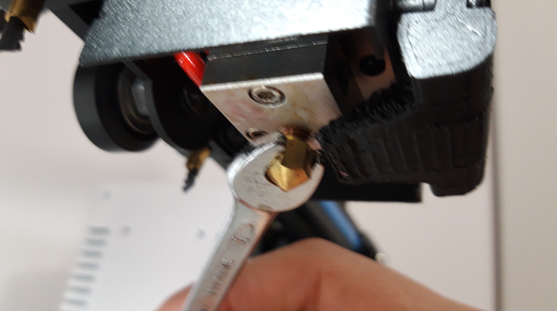

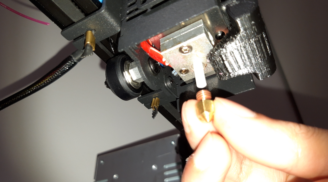

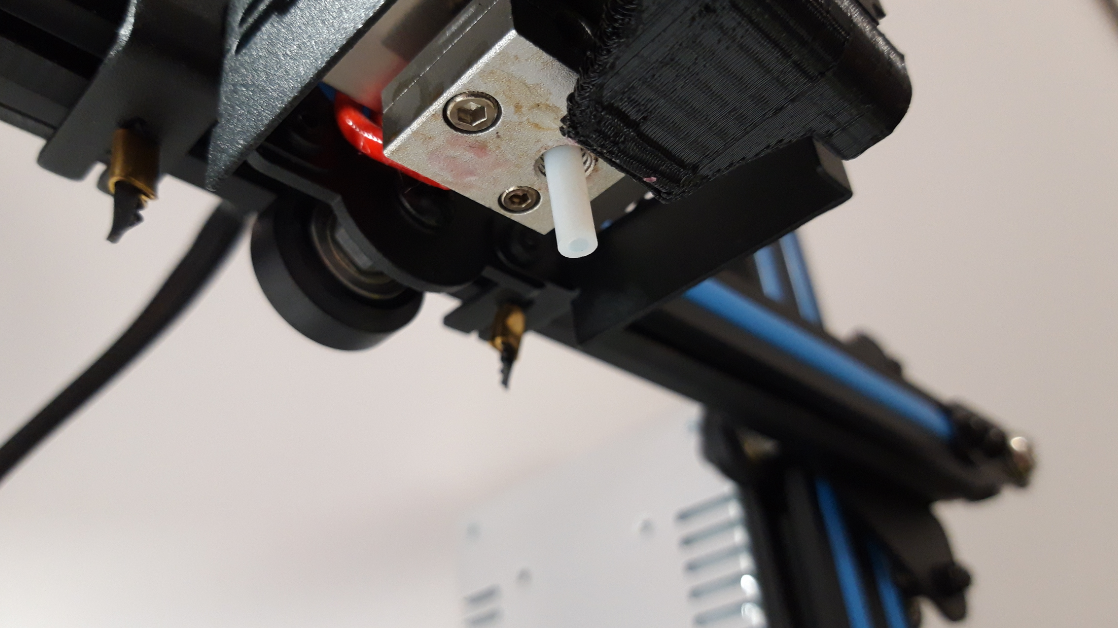

Following the video , for assure that the PTFE tube touches the nozzle I disassembled and checked that the nozzle and PTFE tube were in contact.
(see images B,C,D,E)

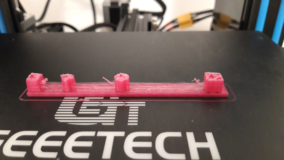

Test 0:
Retraction: 4 mm.
Nozzle temperature: maybe 215 ºC
With this retraction distance I had a good piece until I got a blockade. The machine continued printing without filament.
(see image test 0) Test 1:
Retraction: 3 mm.
Nozzle temperature: 205 ºC
Result: It is blocked
(see image test 1) Test 2:
Retraction: 2 mm.
Result:It is blocked
(see image test 2)
Test 3:
Retraction: 2 mm.
Nozzle temperature: 215 ºC
(see image test 3)
Test 4:
Retraction 2,7 mm.
I put new PTFE tube
(see image test 4)
Test 5:
Retraction 2,7 mm:
Nozzle temperature:215 ºC
I adjust the parameter retraction prime speed with a value of 15 mm/s
Result: it is blocked
(see image test 5) In the test 5 I took a picture of the filament blocked.
(see image test 5 filament)
Do you know why I have blockade with all this test in the nozzle?All test I did with retraction speed 40 mm/s and travel speed 120 mm/s. When the blockade appears I hear the extruder doing noise and it can not fill the filament.

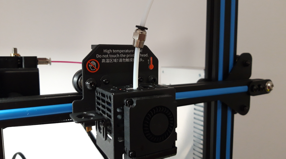

Re: PROBLEM. GEEETECH A10 gets blocked due to the retraction distance
Hi,it may be that the feeder gear is too close to allow the consumables to enter smoothly. You can adjust the adjustment.
You can try the retraction distance of 5mm, the retraction speed of 80-100. And increase the strength of the blower.

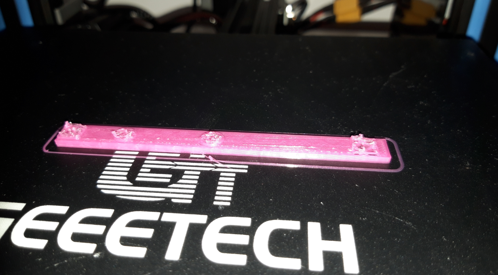

it worked very well. See the following test. I would like to solve similar problem explained in tests 7 and 8.
Test 6:
Retraction speed: 80 mm/s
Retraction distance: 5 mm
Result: it worked with any problem

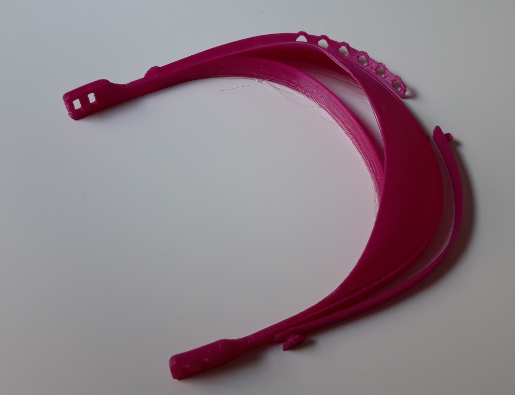

Test 7:
Make this face shield of www.coronavirusmakers.org
Nozzle temperature: 215 ºC but I can not remember if I change to 220 ºC at the end of the test.
Result: it is blocked sometimes

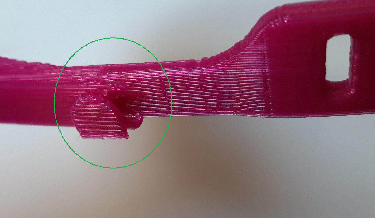

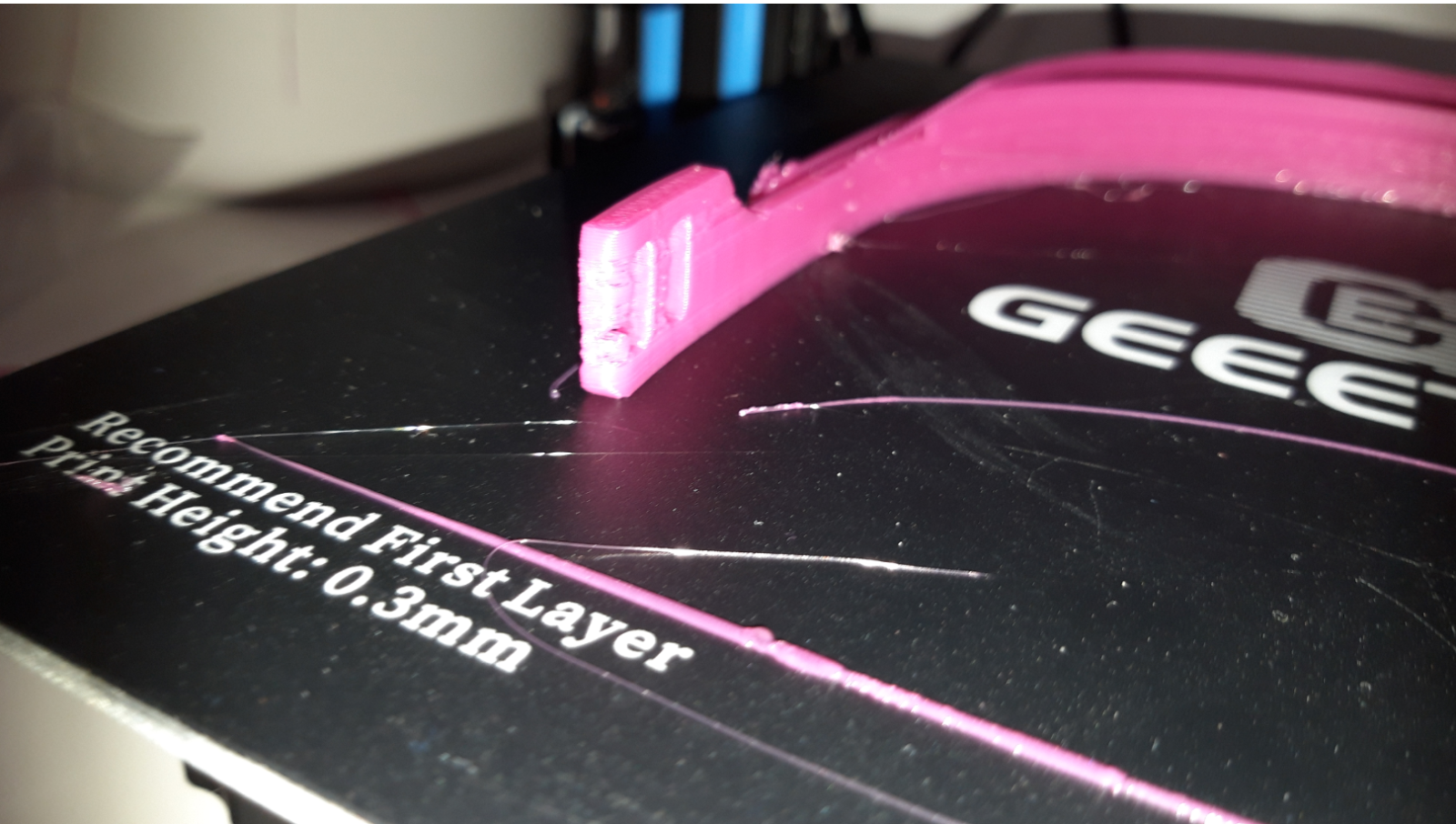

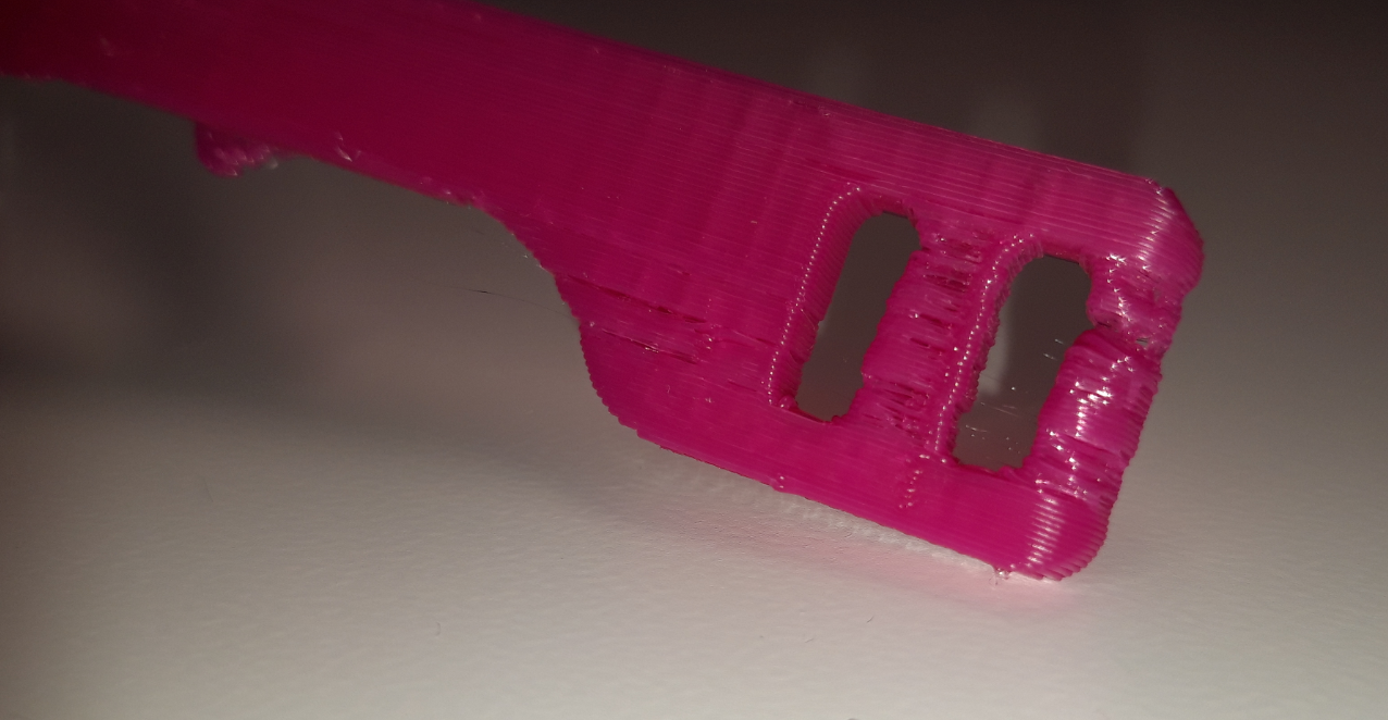

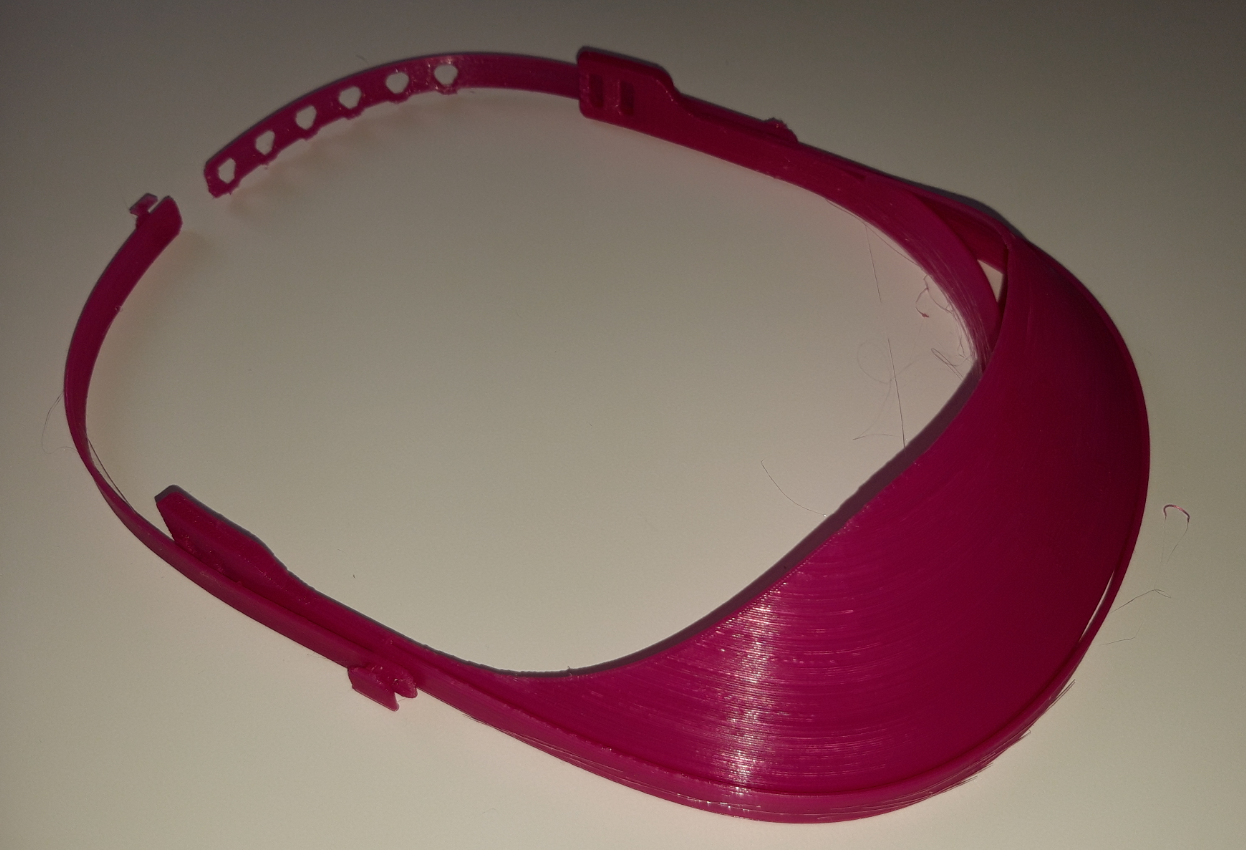

During the printing I noticed that the intermittent blockade was in different areas of the piece.
In the following images I show how the blockade is affecting the piece with parts without material.
There are parts of the piece with no material.
And parts of the piece with not enough material as you can see in the following image. Can you help to solve this problem? Maybe I need to reduce the speed of printing?
In the following video you can see the blockade, but it is not a continuous blockade. 70 % of the printing time is not blocked.

I think that in the video where it is not blocked I reduced a little the general speed manually from the screen of the machine . But I heard still the blockade.
Test 8:
I reduced printing speed to 30 mm/s and selected a nozzle temperature of 220 ºC and reducen speed again with Fr 89 %. It improved very much but the machine is more slower and still in 3% of printing time I hear the noise of the blockade. Do you know how to solve this problem? What do you think with the other questions?

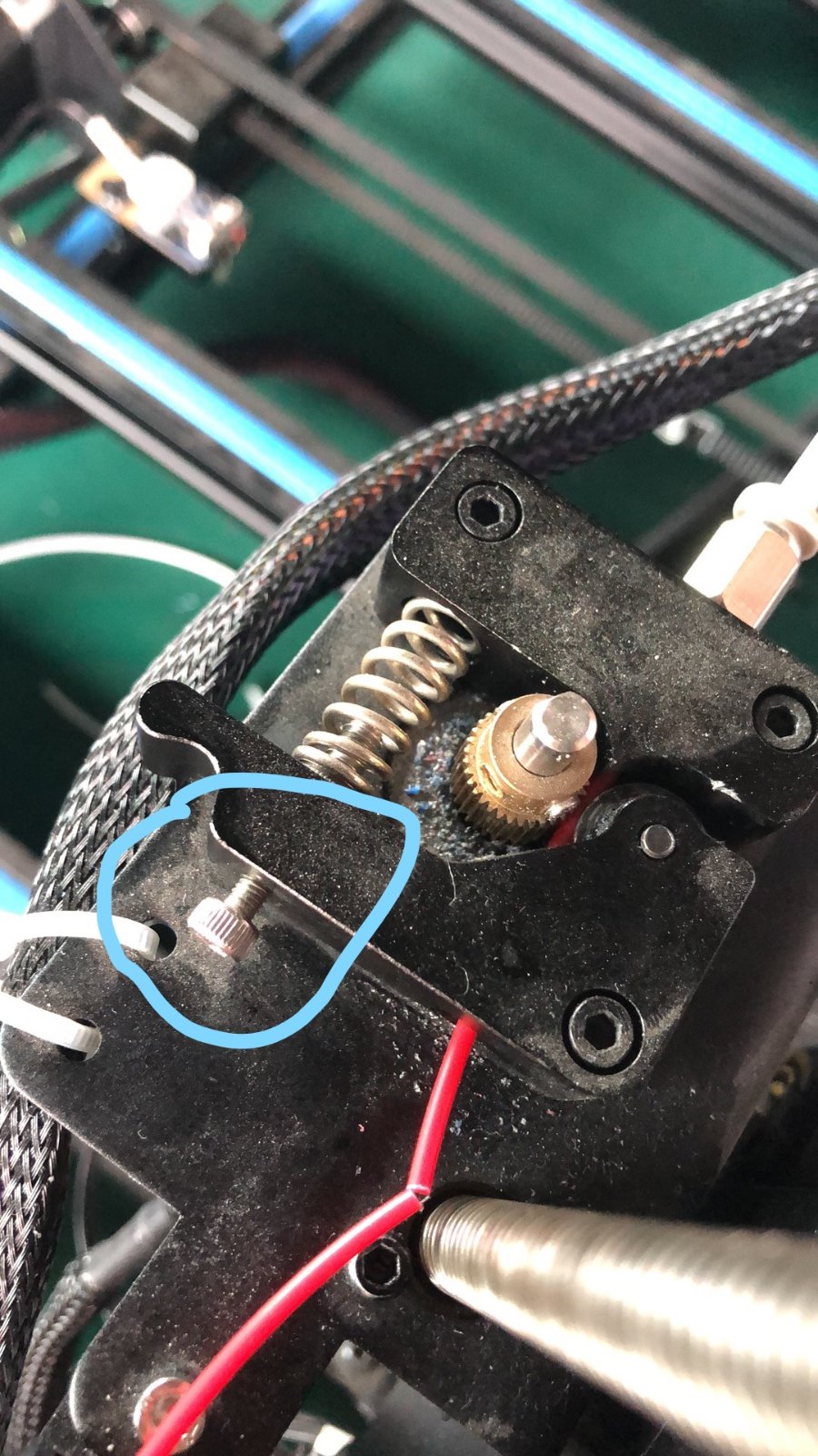

Hi,you can adjust this screw to increase the distance between gears appropriately.
Hi,it is possible that the required diameter of the part part is small.
The nozzle diameter is 0.4mm by default, and thin-wall features below 0.4mm cannot be generated.
Thank you but if you see images test 7.3 , test 7.4, test 7.5 and test 7.6 there are parts good and others bad. If the machine can not do this work it will do not do nothing, but in this situation it works well in some parts and in others not. The most representative example is in image 7.3.William wrote: Tue May 19, 2020 9:41 am Hi,it is possible that the required diameter of the part part is small.

Do you know why do I have this problem? Can I adjust something? I am using 220 ºC.
