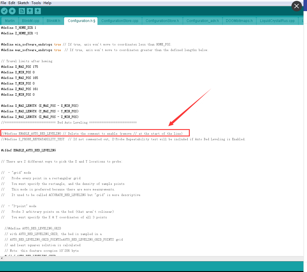

Help! I had to clear the extruder and had to unfix the X belt. Now it homes at "X175 X165" Z is correct. I can move the printer but it has completely the wrong coordinates. What can I do to get the correct coordinates again? (Me Creator 2) I tried the Reset button, Restore Failsafe and set home offsets but nothing worked.

You can check the Configuration.h in the Marlin firmware to see if auto-leveling is enabling.
- HOME.png (50.88 KiB) Viewed 16059 times
