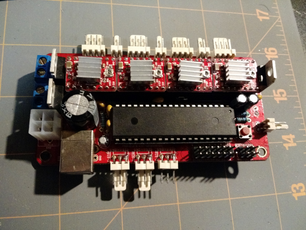

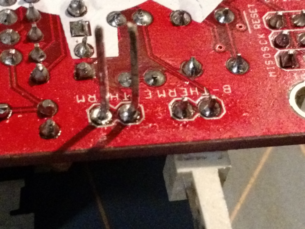

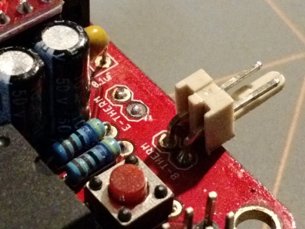

Post by john »
Could you please take some photos for you board and its connection?
darraughbj
Posts: 12
Joined: Wed Feb 25, 2015 3:49 am
Re: Sanguinololu Rev 1.3a, MINTEMP on boot
Post by darraughbj »
Images:
