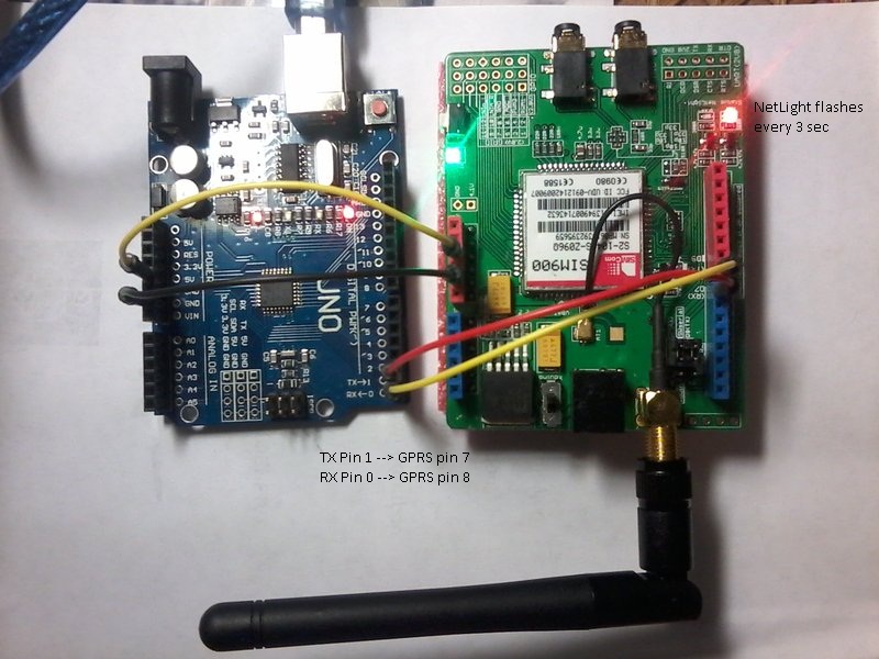

As you can see from the attachment I follow your instructions, load the following sketch to arduino:

but nothing comes to my arduino serial monitor !!!!!!!
Please tell me your suggestions about ....
Thanks in advance

- hardware connections
- rsz_20150326_165655(1).jpg (145.41 KiB) Viewed 21537 times
