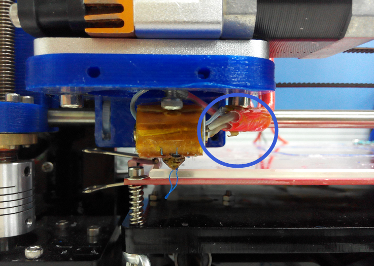

yes, moast of my problems have been resolved except the start position of the print. Where should the print head be in relation to the bed, and why doesn't it put itself in the right position?
zhangxueyou
Posts: 1405
Re: x still crashes against stop and not homing correctly
Post by zhangxueyou »
When the print head is homing, It's position is as shown in the picture:
