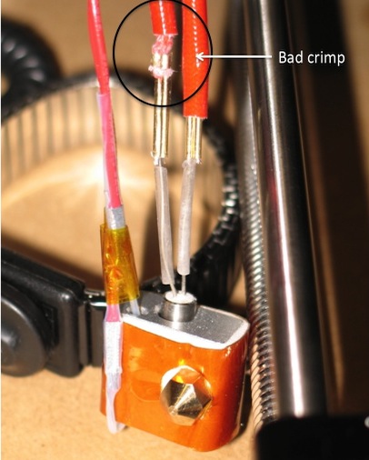

Had the same problem as you, but mine stayed at 12v with the hot end not heating. Ohmed out the 2 wires and found resistance to be ~4Mohms! took off the kapton tape and traced it to a bad crimp on one of the wires. During manufacturing, the crimp tool probably nicked the wire. Then when you go to crimp it, ends up breaking the wire. Had to open the crimp back up and strip a new end and re-crimmped. Since the hot end was open, I re-centered the thermistor dead center to the hot end block, then wrapped the wires back up with fresh kapton tape. All is perfect now, heat regulation tracks and is spot on. Here's a picture of the offending hot end.
Bad Crimp
Bad Crimp
