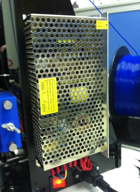

HELLO! IS THERE A WAY TO MOUNT THE DISPLAY PANEL ON THE TOP OF THE PRINTER FRAME. IS THERE A ADD ON MOUNTING PANEL THAT THE DISPLAY GOES ON, OR WHERE DOES IT GO INSTEAD OF HANGING DOWN BEHIND THE PRINTER. DO YOU HAVE A DIAGRAM. CAN THE POWER SUPPLY BE MOUNTED TO THE BACK OF THE PRINTER INSTEAD OF ON THE FLOOR?

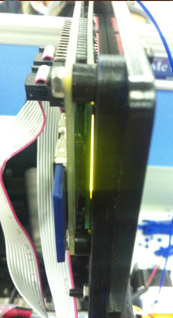

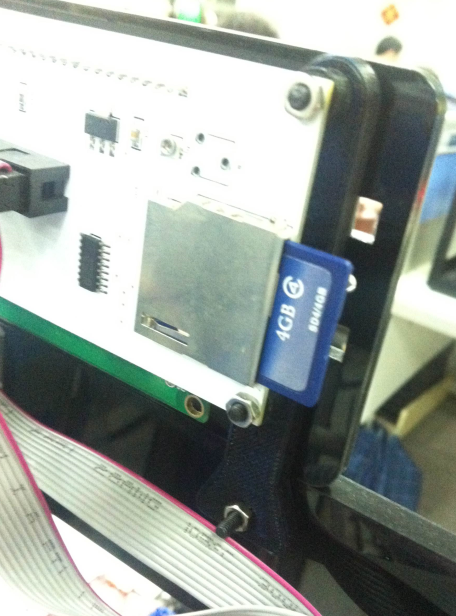

Hi,please look at these pictures:

DO YOU HAVE OTHER PICTURES THAT SHOW HOW THE LCD DISPLAY IS MOUNTED TO THE PRINTERS. THIS PICTURES IS NOT CLEAR TO ME.
