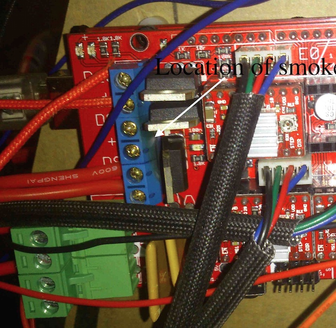

Please turn the printer off. Which part smokes? Please take a picture of mainboard and highlight that part.

I was reading another person's forum, it seems to be from the position of the MOSFET in front of the D8 terminal. It isn't burnt up so I can't show you specifically.
"Re: RAMPS board smoking" is the forum I am talking about. And finally, can I use the coordinates you just gave me for defining the home position? And would that be X(min) Y(min) and Z also (min)?

Here is the picture, I also want to ask for suggestions on how to rotate the board with the fan having direct access to cooling the ramp terminals.
Smoking zone on board

My solution to this is to mount a heat sink with fan of an old video card to the MOSFET. Ugly, but works.
