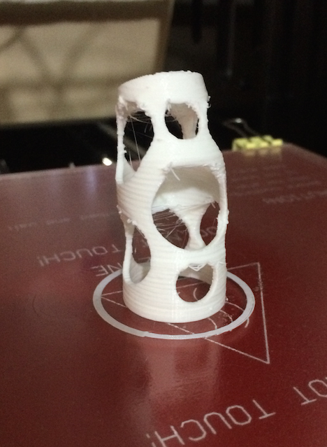

2. After printing several bridge and overhang tests my model failed to some filament flows out in places when the walls are too thin. It means i need to play around temperature settings etc or i just need to use supporting material? For PLA i use 190°- hotend and 70°- bed.
P.S. Example of printing problems in attachement. Will appreciate any advice.

Here is the attachment
- Screenshot 2015-04-07 20.14.20.png (485.79 KiB) Viewed 9282 times

1. The filament ,which leaks out during idle process, will stick on hotbed when extruder is moving to start point.
2. You can try to decrease the extruder temperature to 180 degrees, decrease extruder steps to 90 via LCD(Control>motion>Estep/mm). And you can modify a parameter in slicer setting. Look at the picture,raise the value to 2mm.
