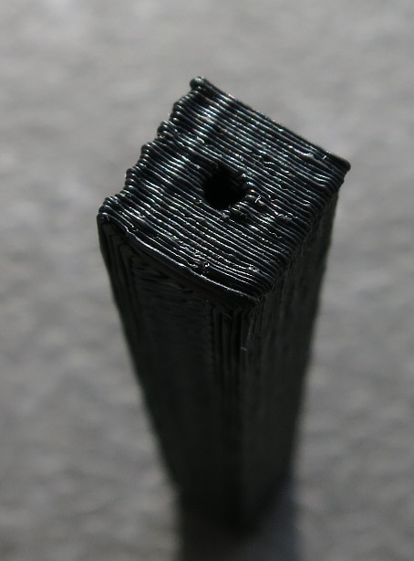

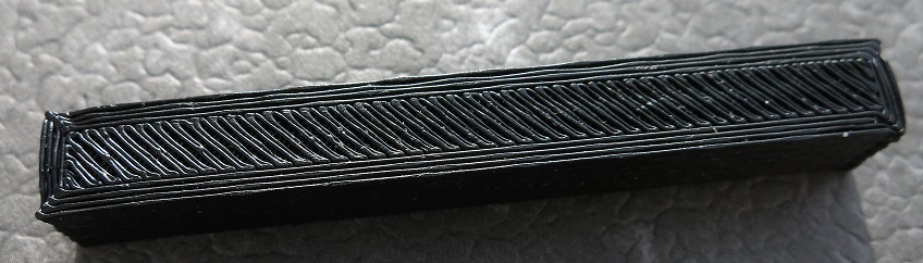

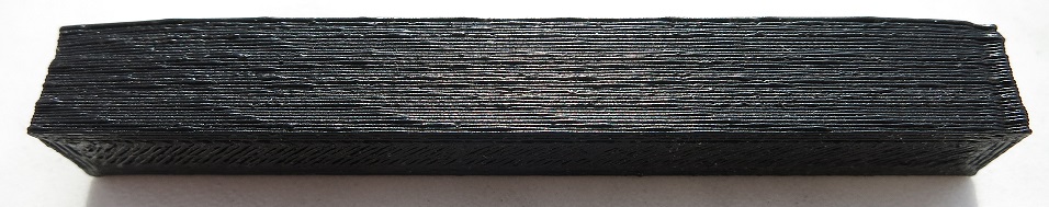

Printer is Acrylic Prusia I3.
ABS plastic.
Default setting in RepetierGEEEtech 0_90D_2, .2mm, 19x15, ABS 1.75mm.
Printed at 260-265C, bed - 110C.

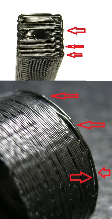

240 degrees for extruder and 95 degree for bed are enough for ABS.
I think you'd better tighten the x belt a bit, not too much.
You'd better give me your slicer settings, give me some pictures, I think your slicer settings are not so good.
Please tell me your nozzle diameter.

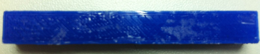

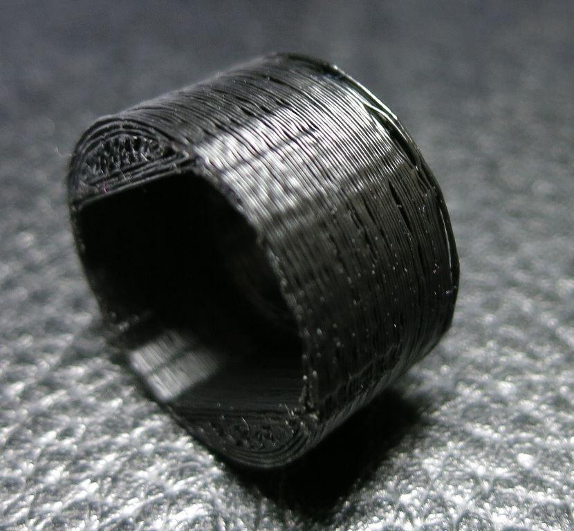

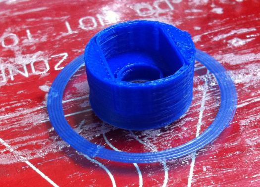

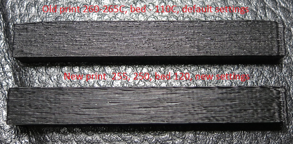

I think 240C for my plastic is not enough - small pellets formed and layers do not adhere good.
Nozzle: 0.3
Filament diameter 1.75, multiplier 0.6
Temperature first layer: 255, other: 250, bed 120.
compare prints: new and yesterday

You can try with my setting. Now that you think 260 degrees is better, then you can keep 250 degrees.
And from the first layer you print, I think you can lower the distance between hotend and hot bed to about 0.2mm.

My setting is based on your setting except speed (my lower) and temperature.
There is 1 sheet of paper between hotend and hot bed .
Why did this happen?

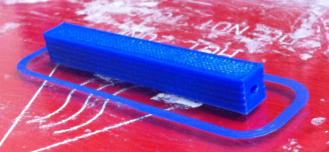

This is the model I print. I think you'd better smear a layer of glue on hot bed.

I print with 240 degrees for extruder and 95 degrees for hotbed.
