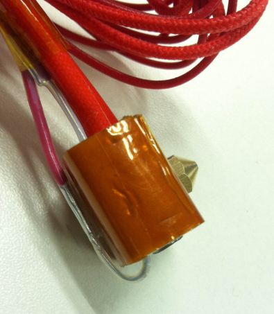

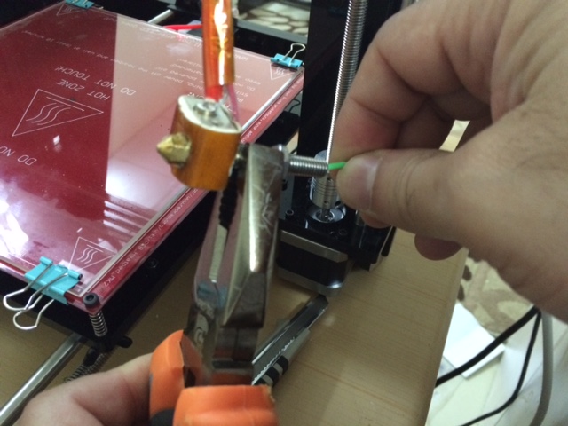

second i dissembled the extruder and heated it and try to push the filament with my hand and nothing goes out as you seen in the picture attached
IMG_8234 (1).JPG (100.36 KiB) Viewed 11675 times
note : temp:250 , filament : 1.75 ABs-b from geeetech , extruder : 1.75 to 0.3

The hot end is block. Please use a thin copper wire to clear it.

zhangxueyou wrote:The hot end is block. Please use a thin copper wire to clear it.
i used and cleared it many times and nothing

When you take the hot end apart like this, can you see any light through the hole?

No , I don't.

Do you have a needle? Please use a needle to clean the hot end when heating.

ok now there is something goes out from the nozzle but when i tried to print something nothing appear usable and flow is slow and didn't stick to the bed .
