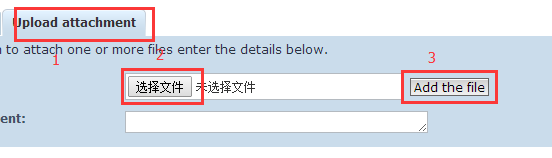

zhangxueyou
Posts: 1405
Re: My stepper motors wont move, any of them
Post by zhangxueyou »
This picture shows how to attach picture:

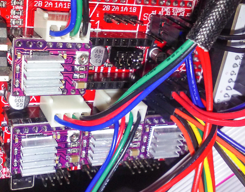

Mattao1977
Posts: 20
Joined: Sat Apr 11, 2015 2:24 pm
Post by Mattao1977 »
Here is the board. Hard to get the size of the picture right.

ok I did that and it just goes to the main menu. No movement. On the ramps is a red led constantly on and sometimes a flashing green one.... Mean anything?
