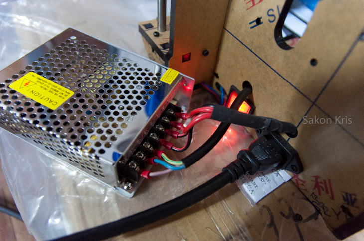

Please take a picture of wiring of PSU, take a picture of backside.

Wiring the 12V 15A PSU

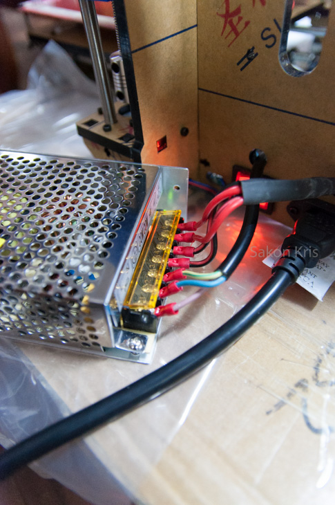

Wiring the 12V 15A PSU back side

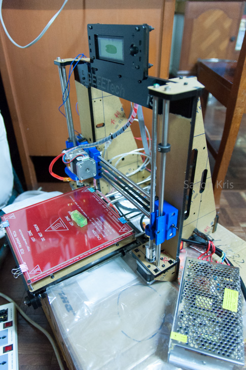

System does not work after press power button. The PSU also has a noisy buzz sound.

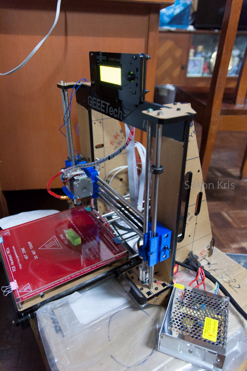

So I change to my LED PSU 12V 10A which look similar.
I wire the cable just exactly like with another one.
Change PSU, it's work!!

It's work!!
The system has activated, but it's power not enough to heat up the extruder head and heat bed.
Power on.
Power on.

What I just only did was swap the PSU.
So please do something about this issue.
Just change a PSU.
Just change a PSU.

Does the input voltage equal the AC voltage in your district? There is a switch under the yellow label "110V 220V", please check.
If the input voltage is correct, please contact the customer service.
