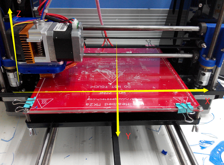

zhangxueyou
Posts: 1405
Re: Mirrored print
Post by zhangxueyou »
These are the positive direction of x , and z axes.
ohruska
Posts: 4
Joined: Wed Apr 15, 2015 4:33 pm
Re: Mirrored print
Post by ohruska »
Thank you for your help.
Everything is already OK.
I had exchanged X and Y axis
Once again, thank Ota
