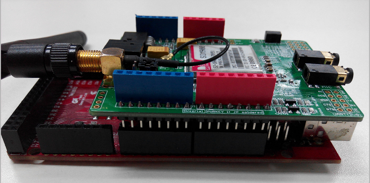

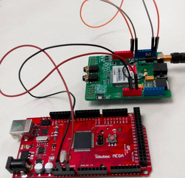

1. Please confirm the board type and COM port are correct in Arduino IDE.
2. When uploading the firmware, don't connect other modules on R3.
3. Keep pressing "reset" button , click "Upload" on IDE, release "reset" When IDE displays "sketch size...".
4. Please try other versions of Arduino IDE.

zhangxueyou
Posts: 1405
Re: Iduino Mega R3 not working / GSM module??
Post by zhangxueyou »
Is this picture clear?
khurram
Posts: 7
Joined: Thu Apr 16, 2015 11:23 am
Post by khurram »
Actually I am using a pcb on the R3 and will not be able to mount the as shown in the picture - I will need to attach them through soldered wires, if you can let me know which wire will go where.
Thanks,
Khurram.
zhangxueyou
Posts: 1405
I can only tell you how to connect with Dupont:
khurram
Posts: 7
Post by khurram »
This is great - thank you!!!
