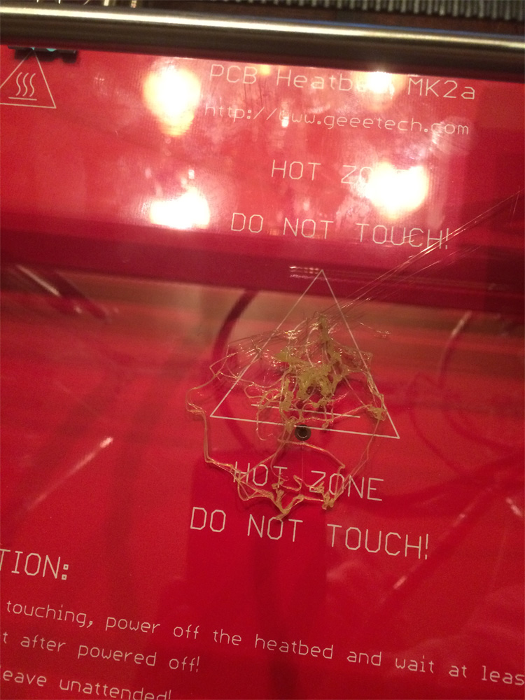

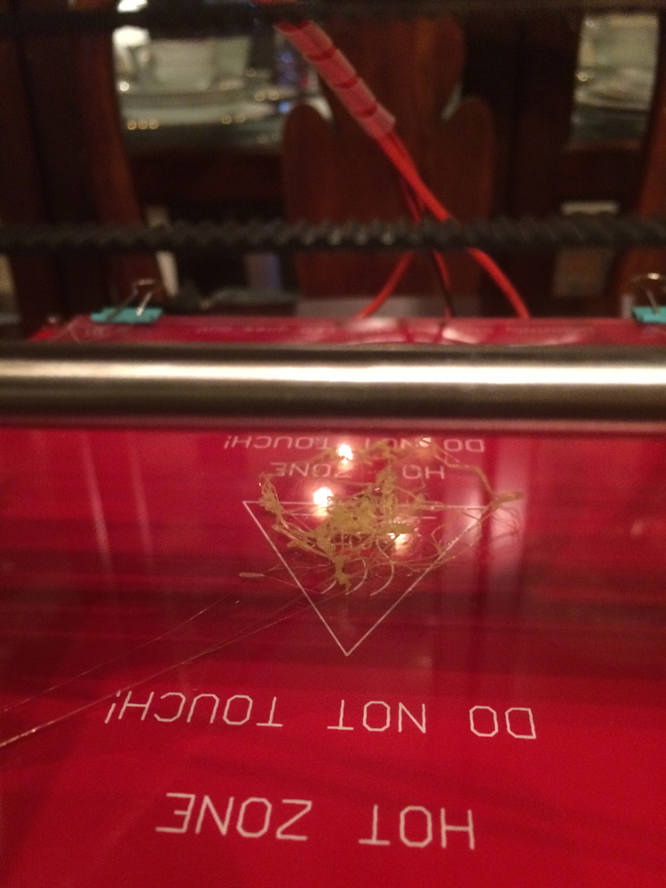

I followed your directions and got the filament in and the printer printing. BTW, it is much easier to load the filament if you remove the fan and heat sink on the extruder. This exposes the inside of the feeder and you can easily guide the filament into place. I ran a test structure that I had following you directions for temperatures for the bed and the extruder and had a problem getting the first layer to stay on the bed. It was being dragged around by the extruder. The second layer was much more stable, but the damage was already done. I'm attaching pictures to show you how the PLA piled up. What can I do to fix this. I did use your version of Repetier to start the run.

Raise the temperture of bed to 80 degrees. Smear a layer of glue or hair spray would be better.
Re: First Print help
Thanks much for the advice. I did the hairspray trick and changed all of the settings in Repetier to match what you recommend and that worked very nicely. My bottom layer is now staying in place.
