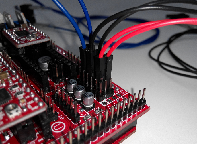

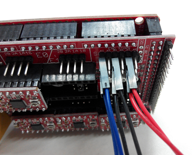

How do you connect the endstops? they should be connected like this:

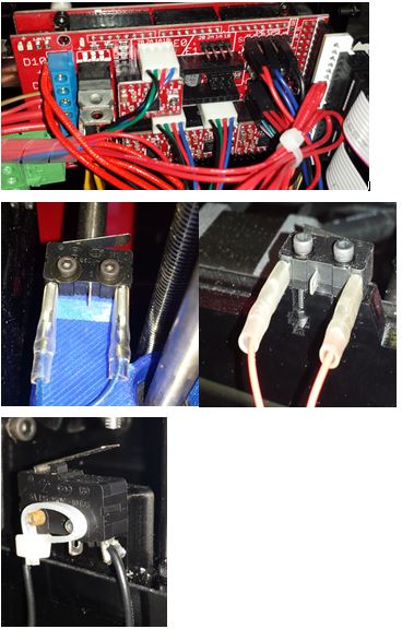

i have attached my pictures of my end stoppers. the one end stopper with the zip tie, i didn't have enough nuts for those screw size
- end stoppers.JPG (54.94 KiB) Viewed 14497 times
Jsantos1214
- Posts: 8
- Joined: Fri Apr 10, 2015 1:26 pm
Re: Ramps 1.4 + Mega2560
my end stoppers

You connect the x and y endstops wrong, you should swap their connections. form left to right should be x, y,z.
And I suggest you should change the direction of mainboard to let the fan cool the MOSFET down, or the MOSFET may be burnt out when heating.
