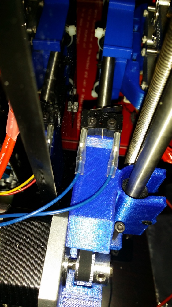

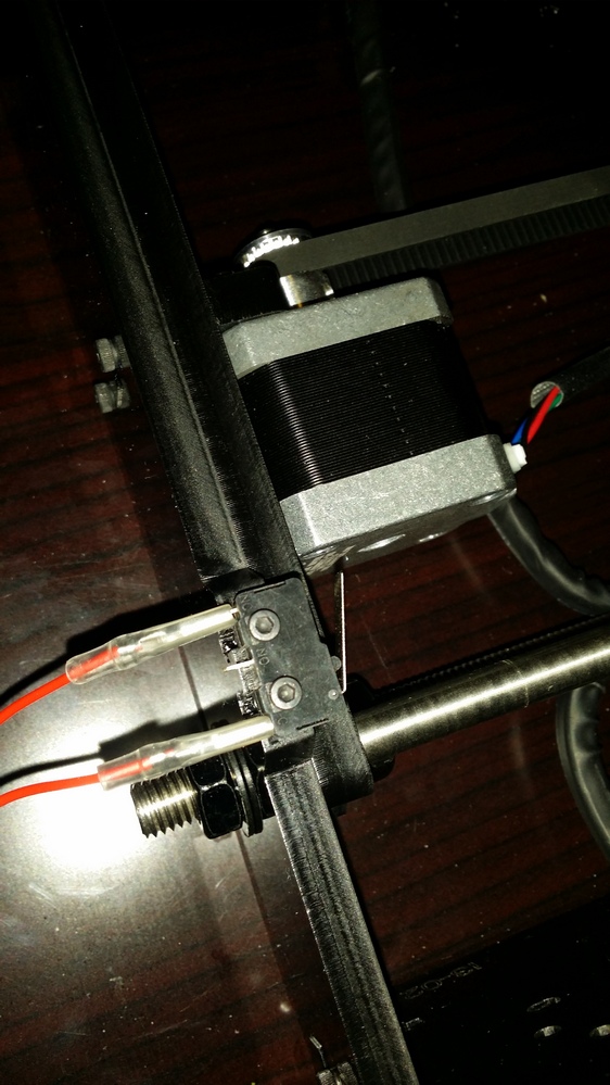

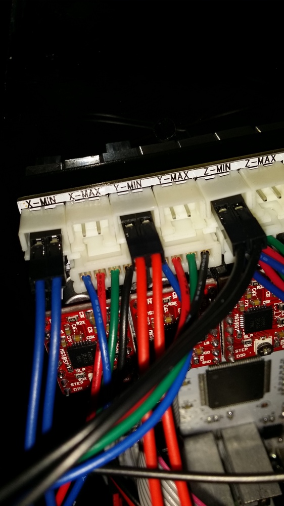

How do you connect the endstops? Could you please take a picture of mainboad , and different angles of printer, let me see the color of wires connected to endstops.

The Z axis is moving fine now, one of the rods threads is damaged and have a dent in it and that was causing the issue, I will talk with the customer service regarding that and some other broken parts later, I will avoid that part of the rod for now Until resolving the one direction movement issue,
I moved all of the end stops from their current position which are labeled as x-min, y-min, z-min to x-max, y-max, z-max and noticed that now I have movement in both direction but when I click home each axis goes to the opposite direction of end stop and obviously when it reaches the end it does not stop until I restart the printer,
also I noticed that with this configuration I have the option to move all 3 axis from the lcd while with the original configuration I only had the option to move x and y,
I moved the end stop connections back to the original configuration for now.

Endstops should be connected to X-MIN, Y-MIN,Z-MIN.
Please check if the wires are well plugged.

yes, as you can see in the picture they are connected properly and working, I made sure bye pressing each one while the motor was rotating and it stopped the motor.
