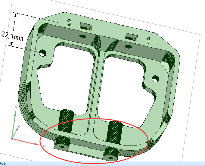

Could you please take some pictures, show me which part not fit?
We can guarantee that the extruder holder and extruder bracket fit the dual extruder.

zhangxueyou
Posts: 1405
Re: How to install the MK8 Dual Extruder?
Post by zhangxueyou »
Unload the 2 fans and gold metal, mount the fan to the holes highlighted in the picture.
vad7
Posts: 28
Joined: Sun Mar 29, 2015 1:08 pm
Post by vad7 »
If I remove these parts the cooling will be worse.
