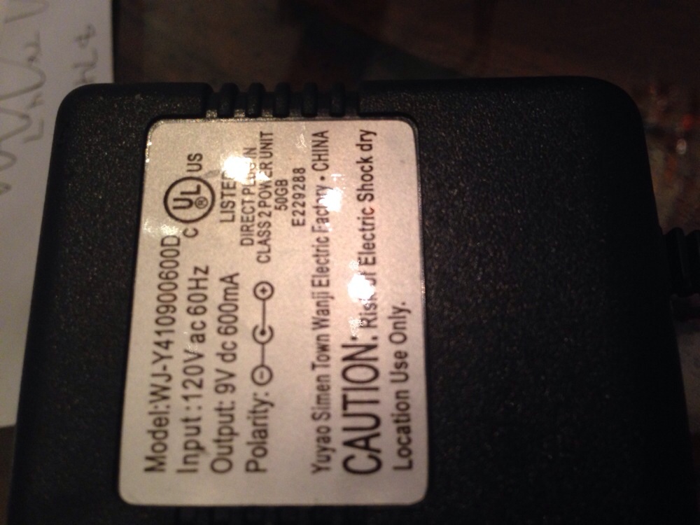

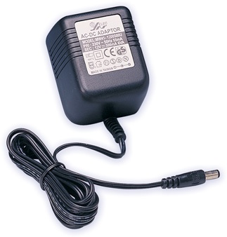

I cut the end off something like this, stripped the coating of the ends of the positive and negative wires and screwed them into the ramps 1.4.

What is the rating of that power supply? When plugging into the RAMPS board 12V connections, with 4 steppers wired in, that power brick needs to feed approximately 4Amps without a Heat Bed and Hot End Attached. The motors enabled will drag the voltage of the power brick down below the operating voltage if it cannot provide the current. The image is too small, so I cannot see what current the power brick you have in the picture is rated at. That brick appears to be too light in power. When you plug that power brick in, what voltage are you seeing at the screw tops of the green connectors '+' and '-' terminals. If it's somewhat near 12V, then make sure the RAMPS is 'married' properly to the MEGA board. If the power brick is rated properly, and connection between the RAMPS and MEGA are solid, double check the installation of you Pololu Stepper drivers to make sure there's no dead short.

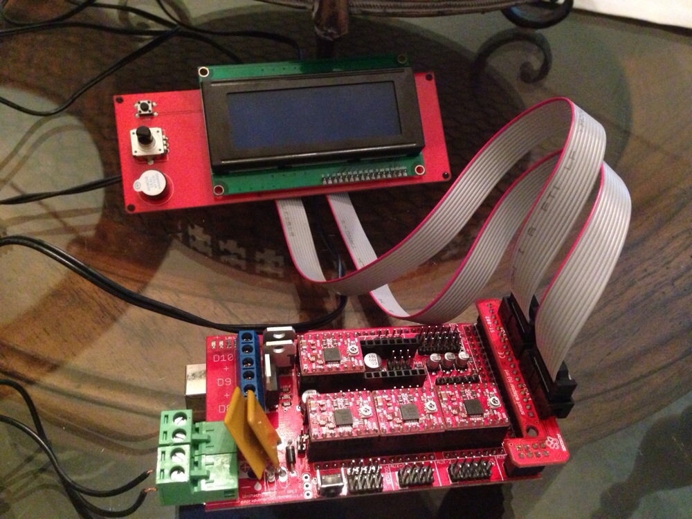

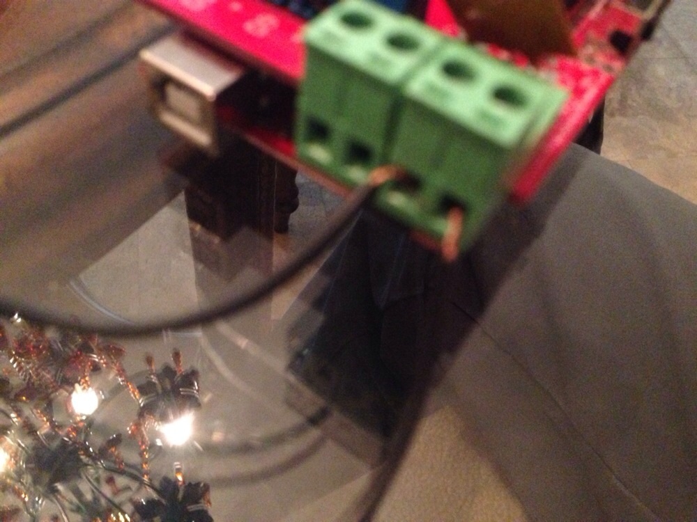

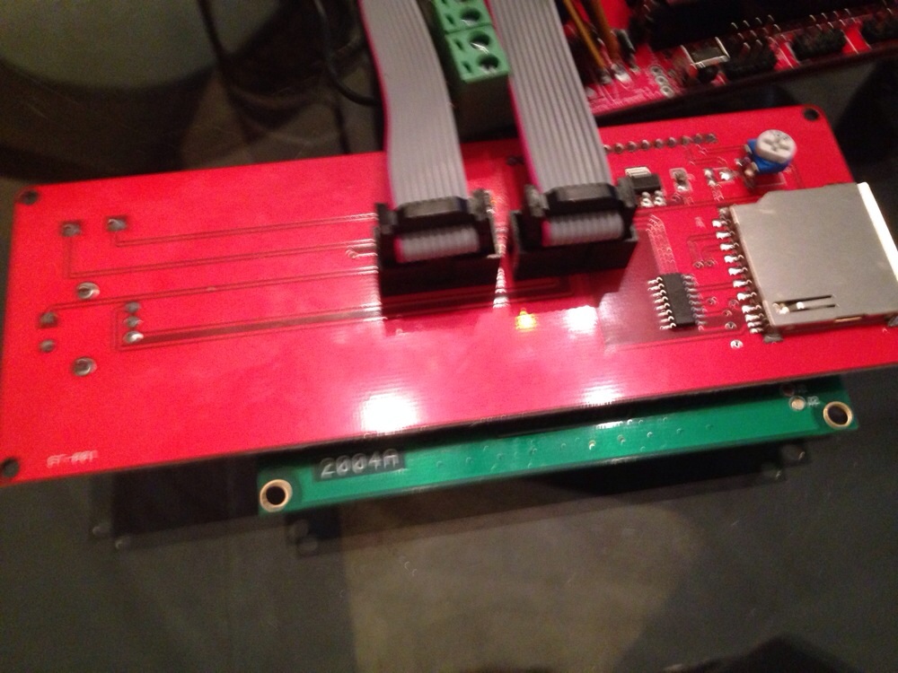

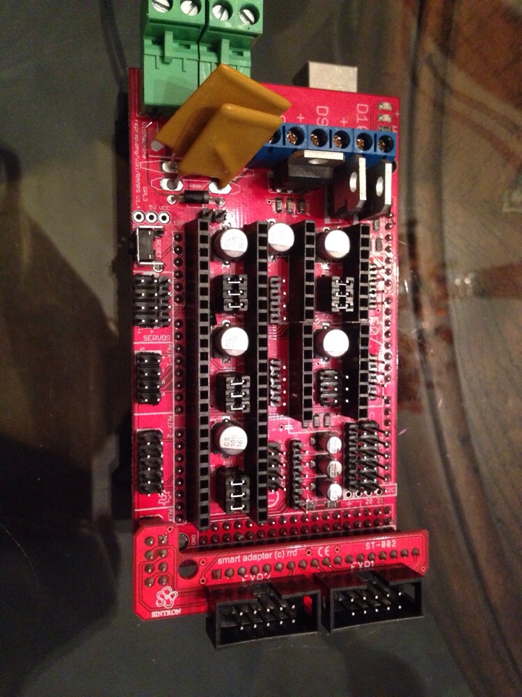

Here are some pictures. Let me know if you need anymore.

Here are some pictures, let me know if you need more.

Juper caps are well plugged, and steeper drivers have been plugged correctly.

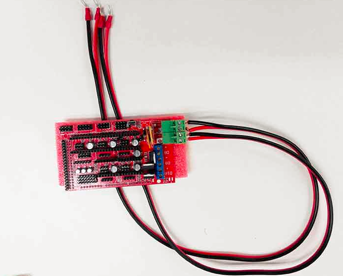

But I find that you only use one group of power for mainboard, and the current is far less than the needed current. The mainboard needs a couple of Amps current. You can see midiman310's suggestion.

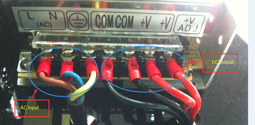

The mainboard needs 2 groups of input voltage with 12V, as you can see there are 4 connectors for connecting power supply.

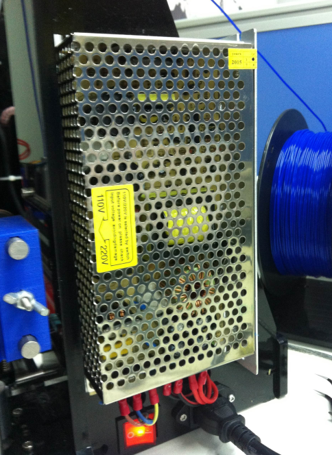

We use such a power supply,with 2 groups of 12V output voltage, to give power to mainboard:
