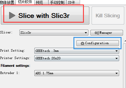

You should slice before printing, the printer can not print without generating g-code. You should click" Slice with slic3r"(My slicer software is slic3r).
If you want to set the slicer, you can click "configuration", you can refer to this page for more details:
http://www.geeetech.com/forum/viewtopic ... 14&t=16366
