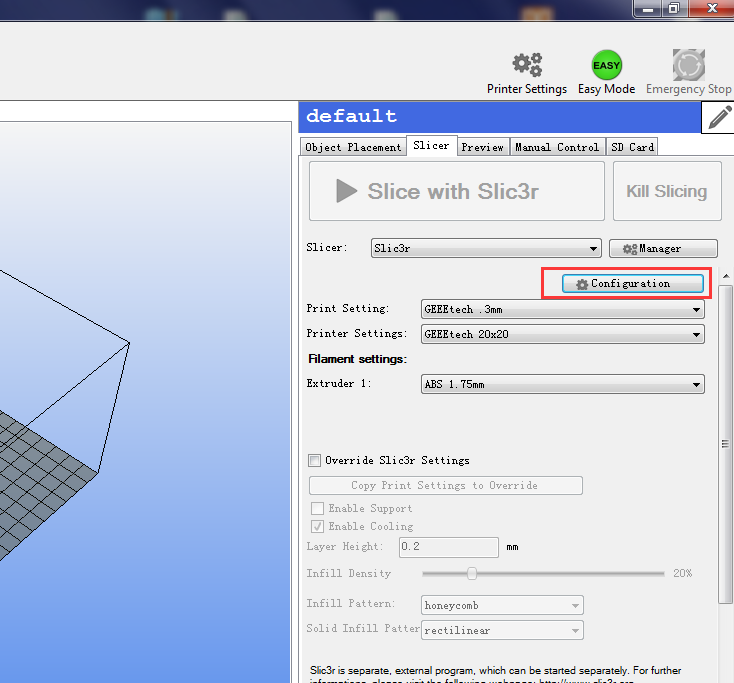

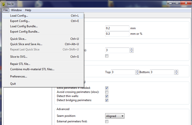

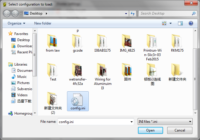

You can also load the configuration file directly.
import slicer setting 1.png (46.16 KiB) Viewed 44042 times
Open slic3r in Repetier Host:
import slicer setting 2.png (52.58 KiB) Viewed 44042 times
import slicer setting 3.png (87.36 KiB) Viewed 44042 times
